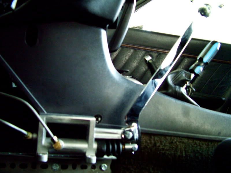

wickiewicked240z Posted September 28, 2007 Share Posted September 28, 2007 Quote Link to comment Share on other sites More sharing options...
bobbyc Posted September 28, 2007 Share Posted September 28, 2007 that's mine there...but don't plan on a ghetto install...i'm actually buidling a box and drilling holes...welding nuts to the back side...and will weld this box to the tranny tunnel so i have a good mounting point in a good location and an over all clean install. Quote Link to comment Share on other sites More sharing options...

palauoriginal Posted February 2, 2010 Share Posted February 2, 2010 I have one in my car. all i can say is that the cnc staging brake with a 3/4 bore is subpar for the z's stock drum brakes. im unsure of its effectiveness with a rear disk conversion but a 5/8 cylinder would probably be a better choice with the stock drums. CNC used to sell 5/8 staging brakes but when i ordered mine they said they only had 3/4. heres a pic: the setup is for sale btw Quote Link to comment Share on other sites More sharing options...
Two80z4me Posted February 2, 2010 Share Posted February 2, 2010 I have one in my car. all i can say is that the cnc staging brake with a 3/4 bore is subpar for the z's stock drum brakes. im unsure of its effectiveness with a rear disk conversion but a 5/8 cylinder would probably be a better choice with the stock drums. CNC used to sell 5/8 staging brakes but when i ordered mine they said they only had 3/4. heres a pic: the setup is for sale btw did you leave your stock e-brake in it aswell? or did you get the staging brake with a line lock? also how much? I need a better sliding brake for these drums until i can get my wilwood set up. Quote Link to comment Share on other sites More sharing options...
