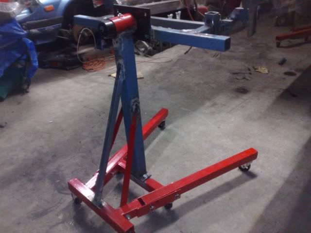

Wedge Posted October 10, 2007 Share Posted October 10, 2007 It looks dangerous ! Does it not want to flex or the motor racks front leg is long enough ? Quote Link to comment Share on other sites More sharing options...
proxlamus© Posted October 10, 2007 Share Posted October 10, 2007 the footprint doesnt look very wide.. what if you rotate it and the jacks tip over? the initial design looks awesome untill i saw the final pic of it in the air. maybe its just the pic.. but it looks kinda unstable Quote Link to comment Share on other sites More sharing options...
JMortensen Posted October 10, 2007 Author Share Posted October 10, 2007 Well it hasn't tipped over yet and I've climbed into the car with it on the stands many many times. I would not suggest that the car be used as a jungle gym when on the rotisserie. But if you're just spinning the car around slowly or sitting in it to weld something, etc, I don't feel that it is very dangerous at all. Possibly my danger threshold is lower than others'. If someone wanted to use engine stands and make it sturdier all that would have to be done is to slide a piece of tubing through the rear tubes of the engine stands, maybe extending another foot or two on each side to prevent it from tipping. I'm finishing the cage and painting the thing and that's it, so for those purposes I won't bother with beefing up the stands. Quote Link to comment Share on other sites More sharing options...

LLave Posted October 10, 2007 Share Posted October 10, 2007 I second the forklift I will have to take a snap shot of my rotisserie, I built it about 8 years ago from extra material that was laying around. It is a bit overbuilt to say the least. Quote Link to comment Share on other sites More sharing options...

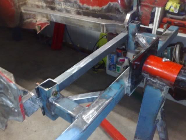

LLave Posted October 26, 2007 Share Posted October 26, 2007 Quote Link to comment Share on other sites More sharing options...

tonycharger72 Posted December 8, 2008 Share Posted December 8, 2008 This was a great idea Jon, firstly how you made your rotisserie (I copied what you did) but also how you put it into position, worked like a charm, just made the rotisserie from 900kg engine stands and added some gussets so connect up the engine stand, set it for 500kg's and put on the rotisserie in about 15mins by myself! Well done mate!!! Quote Link to comment Share on other sites More sharing options...
