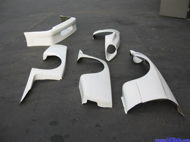

first of all the ZX has an integrated 'zg flare' so mounting the flares gives minimal extra clearance.. however in order to make the whole concept behind flares work .. you sould cut and weld .. In my opinion just bolting/sticking em on looks stupid as you can see it.. and you cant fill em out that way as it would rub the factory lip that the flare sis there to replace in teh first place.
On a s30 you need to bend and tweak those MSA ones a bit as on an s130 ..( the arch radius is bigger than the wheel wells of both cars, it causes them to get a bit wider so to speak) I tried the same set on both cars together with Tony D and sal at MSA..
Apart from a visual thing it would give you much on a zx ... however the fit with minor trimming and adapting..
