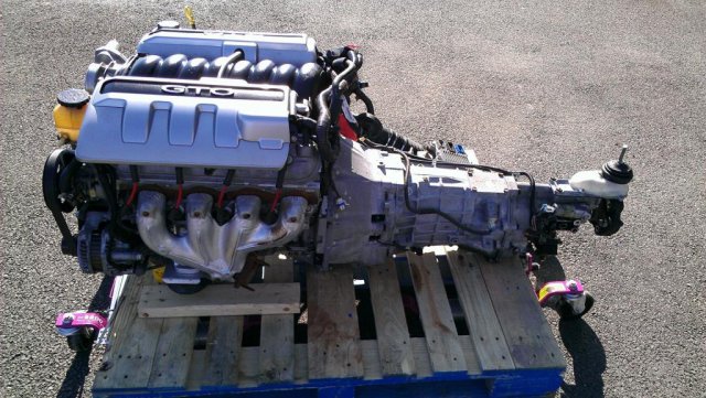

Bigdeezs Posted July 6, 2013 Share Posted July 6, 2013 Sorry to jump on the LS bandwagon but put the LS in for "resale" reasons and then drive the car at track as a last hurrah. We'll see if it gets sold after that. My cammed LS1 has been solidly putting down 420 hp for years without issue except a spun rod bearing on a 140k LS1 that saw probably 50 bottles of N20 and countless 500whp passes in my 3800lb Blazer before it was ever put in the Datsun. The Datsun does nothing but hard canyon driving, track days and sporadic straight line racing all while demolishing GTRs, Corvettes, Lambos etc in all of those areas. I have about 13k in it and I've had failures around the motor and that's about it. Most if not all the problems you've seemed to have involve that SBC and supporting equipment. Quote Link to comment Share on other sites More sharing options...

Mikelly Posted July 9, 2013 Author Share Posted July 9, 2013 (edited) And the only argument I have to all of this is yet this car hasnt been able to achieve any of it and it is due to the lack of ability to get the crank vented properly. Which gets back to the root of why I am pulling and selling this motor. The arguments all make sense until you live the last three friggin' years, of which I have lived. I am done screwing around with and wasting time on this motor. In order to make the power I think I will need, I will have to replace a cam or heads or both and more hardware. So why the HELL not do it with the LS1 and gain the weight reduction on the powerplant in the process??? Not to mention resolving serious exhaust header clearance and flow issues in the process? I know, I know, Its Mike being "Mike" again. On 7/9/2013 at 12:22 AM, pparaska said: Mike, I'm not here to argue about this, I just disagree with your assessment that a SBC can't meet your needs. Personally, I think with the right set of OE and/or aftermarket parts, an LS or SBC could meet your needs reliably. A SBC can make more power and more rpm than your 383 is now. But if you want an LS, then that's cool too! Like I said offline, call up Mast or someone else reputable and tell them what you want to do and get a full bullet built for your needs. This goes for the SBC route as well, by the way. And do likewise for the subsystems that support the engine, whichever you choose. I'm not married to the old school SBC, not by a long shot. My next V8 will be something different. Maybe an LS. It doesn't matter that I haven't driven a Z at the speeds you have on track - there are just too many examples of the SBC making huge power and rpm reliably in high end racing environments at sustained corning, rpm and power levels. For DECADES. It sounds like you want more power and rpm now - that's a new requirement I hadn't heard before. You could do it with a SBC, or an LS engine. None of them will be OE. Which engine has more circle track or road racing hours at elevated horsepower levels? I'm going to have to say the SBC. But the LS is getting there. It is probably true that at really elevated power levels an LS may have an advantage due to the inherent breathing capabilities of the cylinder heads. But you could go SB2 as well...I digress. Not trying to argue - because it's your car and money and time. If you want to go LS, I'm all for it! I just can't agree that a SBC couldn't do it reliably even at cornering, braking, power, speed, and rpm levels above where you are. It's been done many, many times before. I really look forward to watching the LS build/install and then watching the track videos of you hauling ass around the track, without having any more problems!!!!! Edited July 9, 2013 by Mikelly Quote Link to comment Share on other sites More sharing options...
Madovic Posted July 9, 2013 Share Posted July 9, 2013 Mike, while I understand the logic some people are presenting here, the reality is that sometimes changing direction is the only way to get different results. I'm not particularly in the SBC or LS camp, but clearly things have not gone your way on this project, which is sad. Your and Matt Isbell's build threads are the two threads I make time to follow. You both have astounding projects which always help me stay motivated on my project. It is easy to get stuck fighting the same problems over and over again or variations on a theme. Sometimes a somewhat significant change is the only way to look at the problem from the much needed different vantage point to resolve the issue. I tend to believe sunk costs are sunk costs, you need to look at what is the best way to move forward, not the best way to save invested efforts. Despite your evident frustration you seem to be doing a good job of making a plan to succeed rather than simply persevere or "stay the course". Kudos to you IMO. Even if you end up succeeding with a different car (not my personal preference FWIW) I hope to be able to follow your progress. This is completely irrational, but I had a similar experience 25 years ago with a '57 Chevy that simply didn't like the 327 I put in it. That engine had been fine in 2 cars before and 1 after but the '57 didn't like it (again I understand how irrational that is), did fine with the 396 after I got the steering linkage sorted though. Gook luck, Tim Quote Link to comment Share on other sites More sharing options...
pparaska Posted July 9, 2013 Share Posted July 9, 2013 (edited) On 7/9/2013 at 12:36 AM, Mikelly said: ... In order to make the power I think I will need, I will have to replace a cam or heads or both and more hardware. So why the HELL not do it with the LS1 and gain the weight reduction on the powerplant in the process??? Not to mention resolving serious exhaust header clearance and flow issues in the process? I know, I know, Its Mike being "Mike" again. Yeah, if you have to replace all of that stuff to get the power you need, A totally new engine, designed and built with the power and rpm levels needed is the best option! So you might as well start with something lighter and easier to route the exhaust with, all else being the same, if so. I wasn't aware of the "requirements creep" and that changes things considerably - only (some) of the shortblock would be useful at this point. Edited July 9, 2013 by pparaska Quote Link to comment Share on other sites More sharing options...
