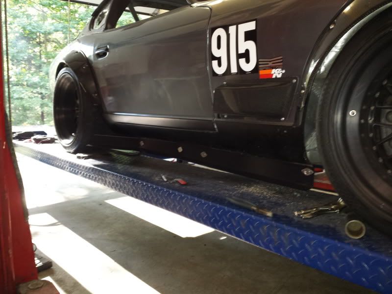

Back from vacation. I plan to get into the shop today and get prepared for a new round of work on the Zcar. I hope to get the drivers side and the spats in front of the rear tires that will close out the rocker.
And of course, I still have a mess from post chumpcar race at VIR that needs to be put away. Parts still laying around...
