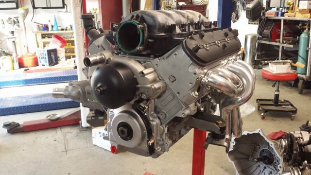

Little bit of tech info...Callies Compstar forged rods/crank, SRP pistons, L92 Ported heads with this bullet cam:
I'll be running a drysump, LS3 intake and a host of bits and pieces.  I am re-using my TKO600 trans, and I will be installing my Tilton hydraulic release bearing instead of the clutch fork/wilwood pul style slave I previously used.
Mike
Edited by Mikelly
Why are you changing clutch release mechanisms? Did the other setup give you trouble? I have not enjoyed having the hydraulics inside the bellhousing on my car. What bell housing are you using? Those headers sure look fine-what is it about headers that looks so (I hate to say it) sexy? Love your motor mounts-getting the driver side mounting bolt in and out has been a pain with the JCIs, but no welding was required so I'm still happy with it. If I was yanking motor more, your kit looks lots better.

On the LS3 front, the motor is coming together. I have the intake in and the drysump parts are on the way. I hope we will be able to get the other bits in this week.
