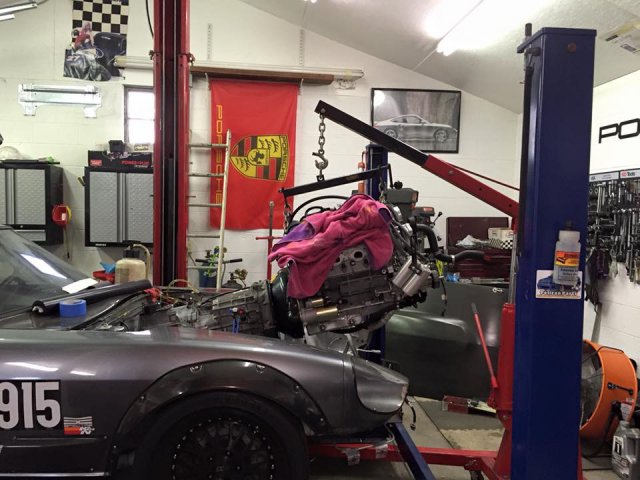

Mikelly Posted December 5, 2015 Author Share Posted December 5, 2015 Its amazing what good drugs and a healthy son can do for a project!! Motor, trans and driveshaft are in... Quote Link to comment Share on other sites More sharing options...
1969honda Posted December 5, 2015 Share Posted December 5, 2015 That's awesome, glad family came thru and helped you out. Quote Link to comment Share on other sites More sharing options...

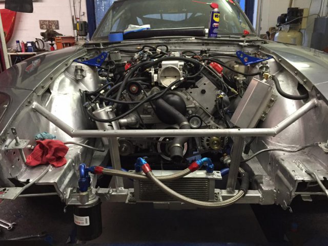

Mikelly Posted December 7, 2015 Author Share Posted December 7, 2015 Got a bunch done on the Zcar this afternoon after work. Some of the connections made, motor mounts tightened up, headers bolted up, coil pack brackets bolted up... Tons of small stuff... Quote Link to comment Share on other sites More sharing options...

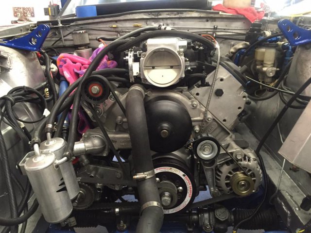

Mikelly Posted December 15, 2015 Author Share Posted December 15, 2015 So I managed a little time out in the shop today before the back and the wife protested... Quote Link to comment Share on other sites More sharing options...

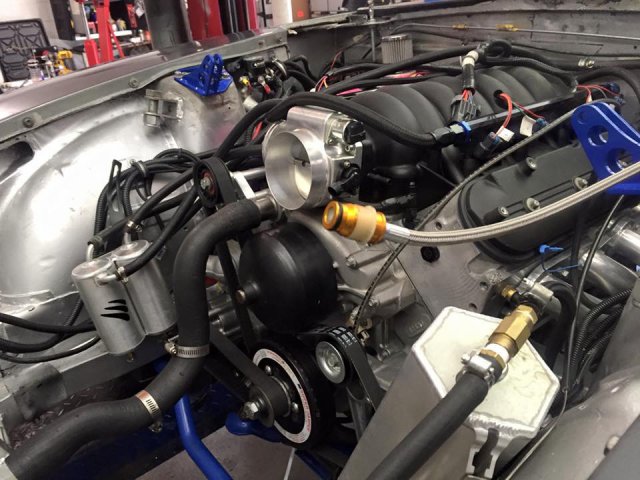

Mikelly Posted December 22, 2015 Author Share Posted December 22, 2015 (edited) I took care of a host of issues on the list this evening, to include: Installing the springs in the -16 return line Extending the coolant temp sensor wiring Tightening/Checking all Steam fittings Tightening/Checking ALL oil lines Tightening the brake booster clamp Charge Battery Connect FPR VACUUM LINE Made a lot of progress in less than 1.5 hours!! Edited December 22, 2015 by Mikelly Quote Link to comment Share on other sites More sharing options...
