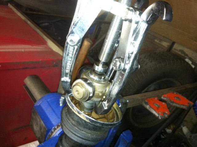

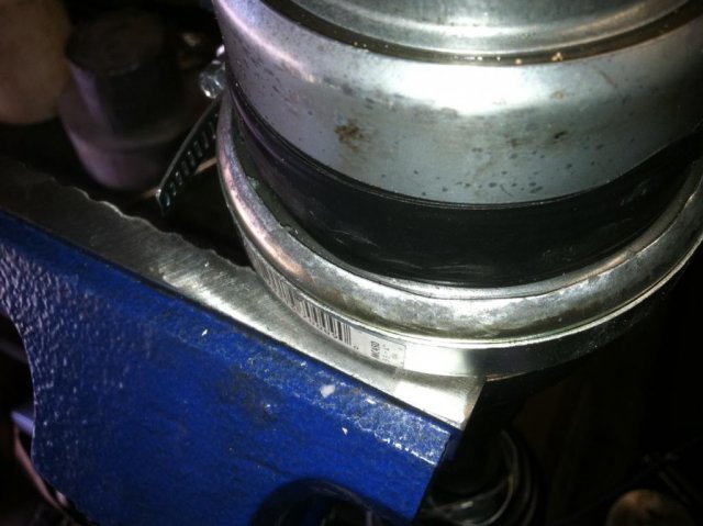

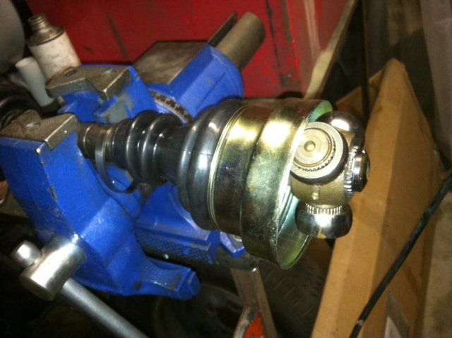

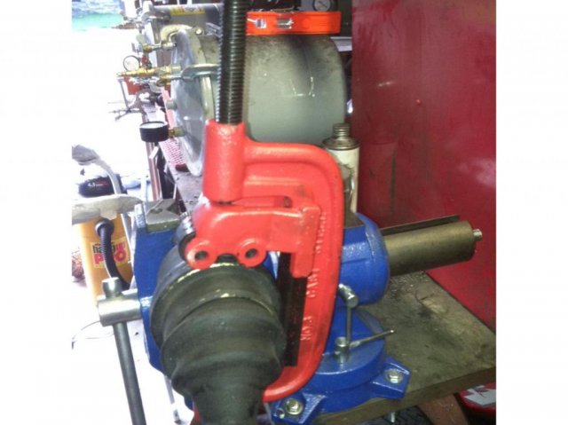

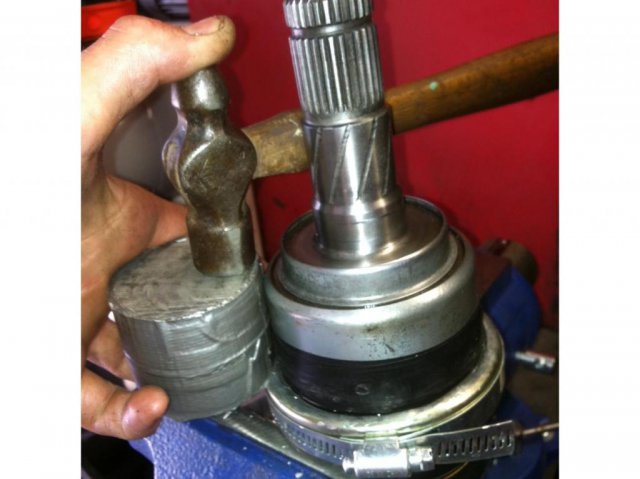

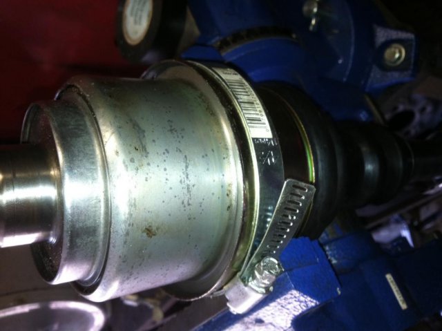

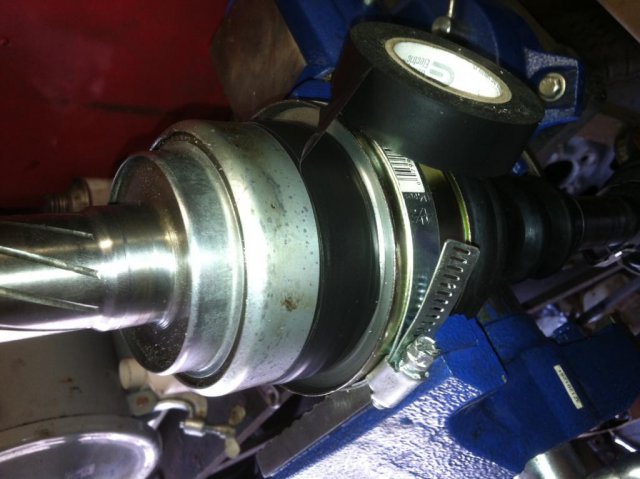

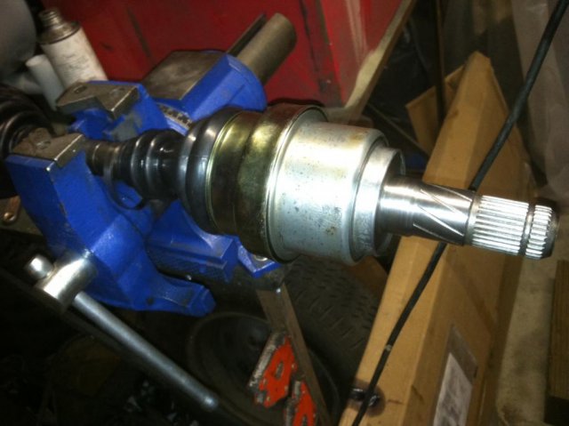

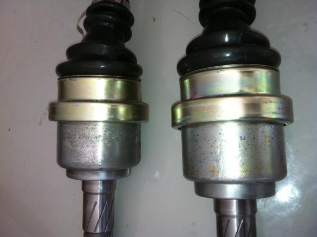

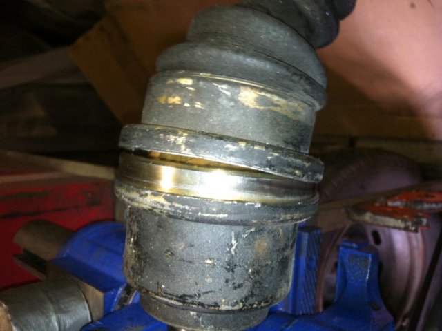

nix240z Posted June 22, 2013 Share Posted June 22, 2013 (edited) Since the pics are gone, I am posting pics of the way I did my boots. pipe cutter #3 from harbor tool $20.. go slow and dont let the pipe cutter walk on you. You might get a small grove on the axle side from the cutter but this will be ok. Boot band cut in half. NOTE: I used a small Dremel cutting tool to mark the exact location of the parts as they came off the shaft, so i would know the location as they go back on. My cv's did not have a c-clip, the end was just pressed on. I used a 6" 3 jaw gear puller to remove the end install the new boots and reinstall the parts the same way as they came off. I used a 28mm socket to tap the end back on. On the shaft there is three places that the shaft was mashed down to hold the end in place. I just used a small chisel and mashed them back further after end was installed. Pack boots with grease and put the Boot end back on. At this point I installed a 4 1/2" worm clamp around the metal boot. This helps protect the metal as you start hammering the lip over and also keeps the band from wanting to bow out. I also put electrical tape around the boot to also protect the metal while tapping the lip over. At this point the lip is almost all the way around after tapping it. Small light taps will get the job done. At this point I used some aluminum stock I had to tap the lip the rest of the way down. I did so tapping and moving along the ridge. You could use a socket and get the same result. completed boots... Edited June 23, 2013 by nix240z Link to comment Share on other sites More sharing options...
