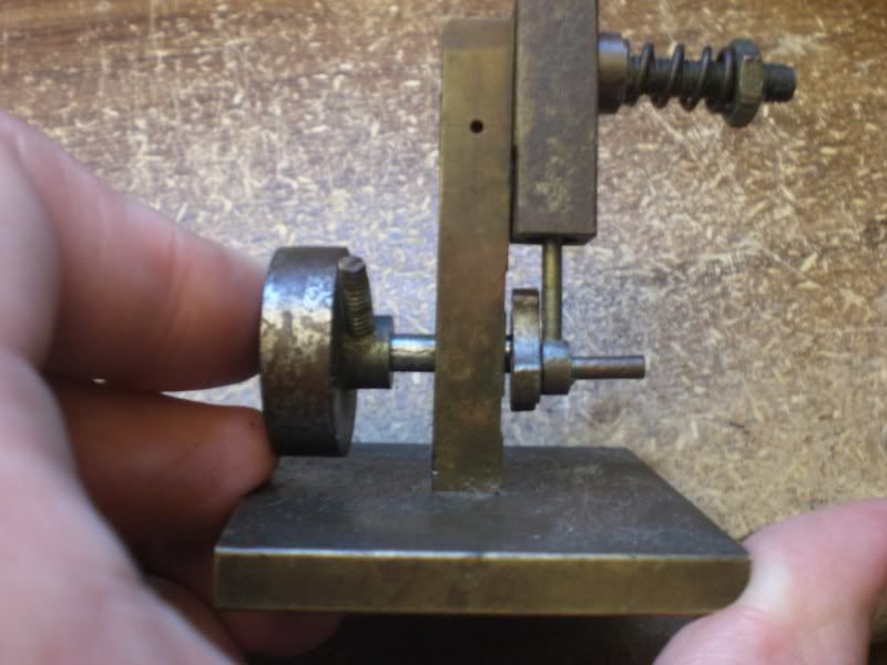

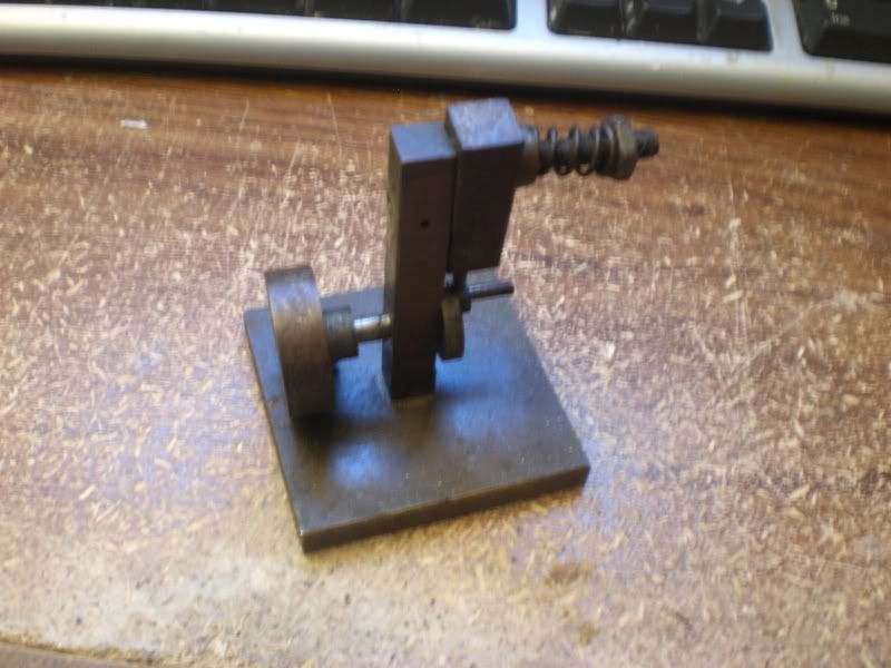

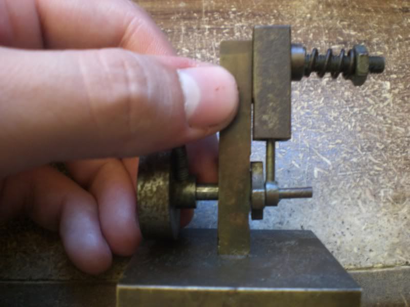

Here is a little air motor my dad built when he was a teenager:
Notice how in the last 2 pictures I moved the crank in and out but only slightly. This motion limited the motor to about 8000RPM. If we were to make another one but with finer specs, I'm sure we could hit 12k. the way it works is the cylinder moves with the piston. It wobbles side to side and when the ports align it draws in air, and then when it moves away from the ports the air flows out. You can find videos of it on Youtube.
