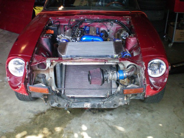

280zjoel Posted May 23, 2008 Share Posted May 23, 2008 ok long story short i have my 1972 240z in the garage. i go to college and am going to take an engine building class next fall. i was going to build a l31 and turbo or twin turbocharge it. i already have the l28 and the crank to stroke it. but i was thinking of other CHEAP unique options to make large power (between 400-500hp) and thought that since sr20s are constantly dropped into 240sx's couldnt i get sr20 mounts for my Z and drop a KA into it. I can pick one up super cheap. internals arnt bad price wise then i would turbo it. im sure someone has done this but i did a quick search and didnt find any pics. so would this be a good budget build or what? and are there any 6 speed transmissions that could be hooked up to a ka24? i love my 6 speed in my RSX-s (which im selling) that extra gear is just fun Just to give you heads up, im doing an sr2det swap in my z but its the same stuff you will need for your ka24det. - custom cross member (welds onto the frail rails and sits further back) - Drive shaft cut and shortened - wiring, piping, ect.( stuff to get it running) if i find a good pic. of the cross member ill post it, you can contact Alex or Adrian from Vildini motorsports http://vildinimotorsport.com/ they can make the cross member for you and you can just weld it in. if your going to do a ka-t swap ya might like to do a top mount intercooler like how im doing mines, since there is so much more space in the engine bay and less ic piping= better throttle response. as far as price wise goes, it depend on what you want to get done, I'm at $6k for all the engine work and fabrication just to give an idea of how much it would cost. Quote Link to comment Share on other sites More sharing options...
sorealsosurreal Posted May 23, 2008 Author Share Posted May 23, 2008 yeah i was thinking i would buy the cross member from mckinney, http://www.mckinneymotorsports.com/products i havnt heard anything bad about them so i was gonna buy that crossmember. a ka24 i can pick up a whole lot cheaper then an sr20. that and i need the motor to build for a class and the sr20 internals just seemed more expensive as well. i like the top mount intercooler but im just curious as to how much airflow you'll actually get verses a FMIC. and amoung all other things im trying to do something that isnt done often, or atleast not that ive seen. i actually live right by vildini and ill probably swing by there some time to ask some questions and see what they think or any info they can give me to help me along the way. im a technician at a shop myself so i plan on doing alot of the work myself which will cut down on costs as well. Quote Link to comment Share on other sites More sharing options...
