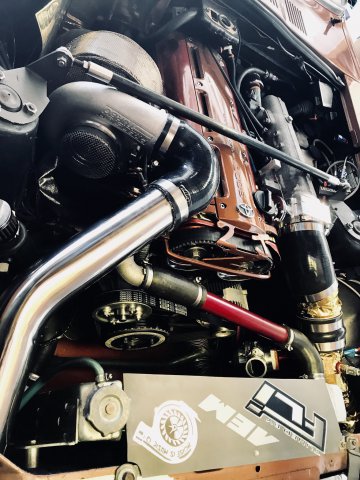

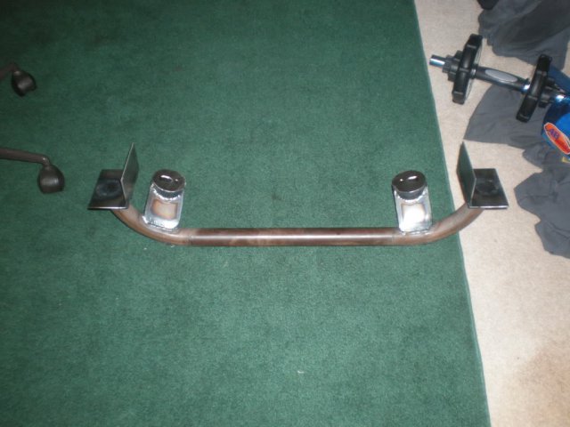

OverkillZ Posted April 17, 2018 Share Posted April 17, 2018 Hey guys I had to Make a new profile for some reason but The OVERKILLZ is getting back together. I spent about 10k in upgrades and plan to hit the 1000WHP MARK! New precision 72 turbo ID2000CC injectors Magnafuel 750 pro BC Stage 3+ Cams (276's) New Exedy Tripple plate clutch New fuel lines -10,-8 Almost done re doing the fuel lines then back to the duno. The car already made 500whp at 8psi but ran into fueling issues. ANOTHER NOTE- I BOUGHT THE JOHN COFFEY(betamotorsports) 2JZ/1JZ ENGINE MOUNT JIG!!!!!!!!! THEY ARE MADE TO ORDER at 350$ a pop. Quote Link to comment Share on other sites More sharing options...

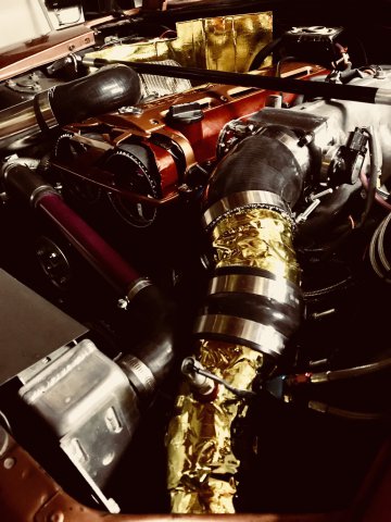

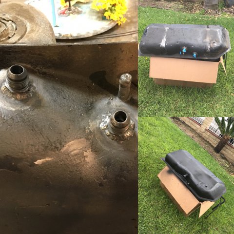

OverkillZ Posted May 17, 2018 Share Posted May 17, 2018 Made some changes to the inetercooler piping to match the new precision turbo. Went from 2.5 inch to 3 inch piping Ran into fueling problems with the new massive fuel pump. Had to put -10 feeds into the fuel tank and redo the fuel lines. Quote Link to comment Share on other sites More sharing options...

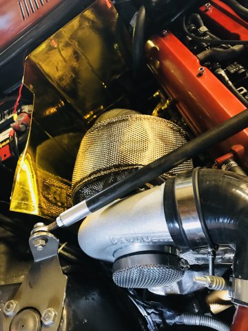

OverkillZ Posted August 13, 2018 Share Posted August 13, 2018 So as you all can tell.... I didn’t sell the car.... I did it he stupid thing and put 10 more grand into it LOL..... The build had its limitations and everything was pushed to the max so I upgraded yet again! went to a smaller turbo precision 72/75 gen2 went bigger injector ID2000s went to a bigger fuel pump manga fuel 750 BC stage 3+ cams/springs and titanium retainers redid fuel tank feed lines went to a stock intake manifold(drivability) went to a Exede triple plate clutch cars running and driving now just waiting for dyno time. Quote Link to comment Share on other sites More sharing options...
