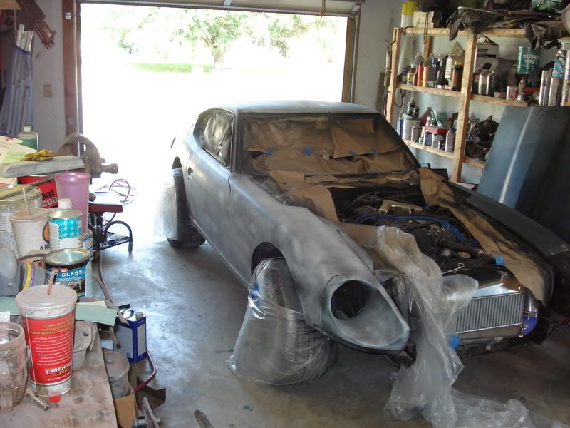

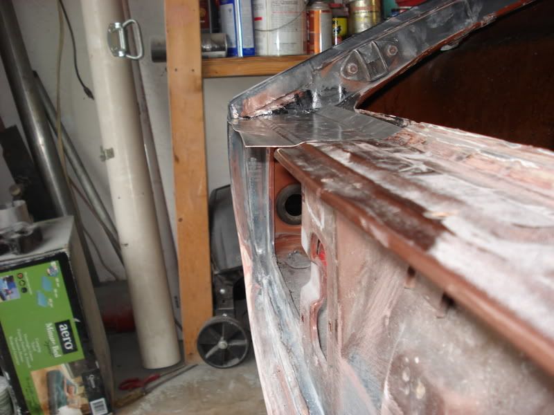

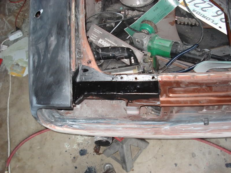

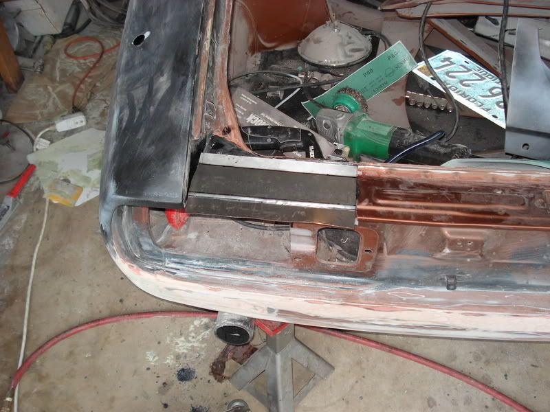

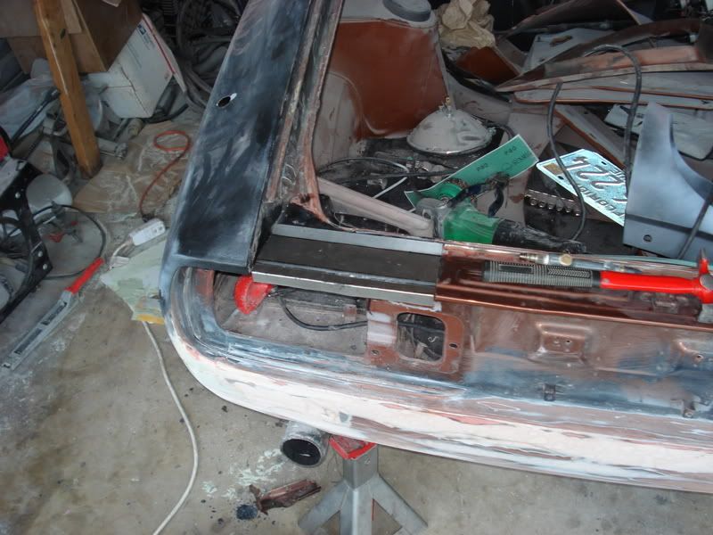

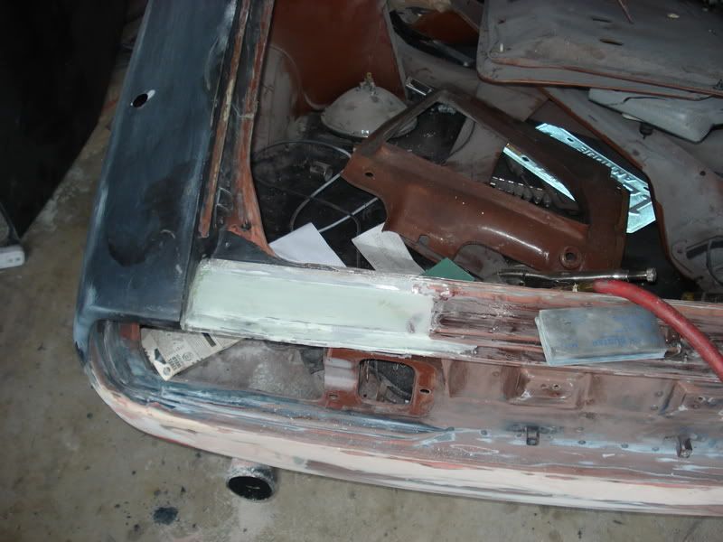

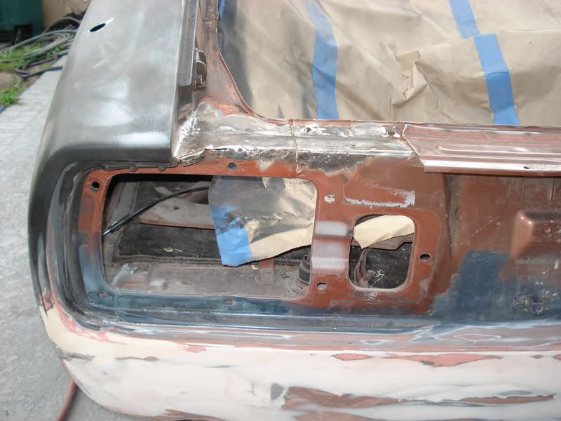

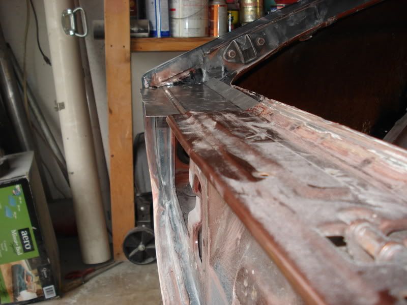

jeffer949 Posted July 31, 2008 Author Share Posted July 31, 2008 Alright every body Ive been busy doing all the "little thing" that need to get done like sanding all the door jambs and the inside of the doors, filling alot of little imperfections, and all that jazz. It is taped up right now and im going to lay down 3-4 coats of high build primer tomorrow morning and then ill do my final block sanding along with guide coats. Its getting really close to being ready. Im getting really nervous because im going with such a dark color that if i mess up on the body work it will really show. Oh ya i also fixed the rust spot on the rear deck. I made that patch panel out of just some flat stock i had laying around. Im pretty stoked how it turned out. I was impressed it came out so nice considering i didnt have a break and i made it with only a vice and a hammer lol And on to the pictures!!!! Guide coat on half the car. pictures of the rear deck repair. Quote Link to comment Share on other sites More sharing options...

Pharaohabq Posted August 5, 2008 Share Posted August 5, 2008 jeffer949 said: Ya im def. going to paint everything. If i really decide i dont like it i can always paint it black. I actually bought my paint yesterday so im getting close. Im actualy gonna try and spray my door jambs tonight. I went with a Cadillac CTS color, its called Blackcherry. Here is a link to some pics of one that actually shows you the different angles and what it can look like. http://www.chicagolandmustang.com/forums/showthread.php?t=25753 Linkee is farked... Got another one? Oh and Definitely go with the painting everything, it looks much more classy. Great job on the Rust repair on the hatch. it looked really good, did you weld the patch in place? before the bondo? Phar Quote Link to comment Share on other sites More sharing options...
jeffer949 Posted August 5, 2008 Author Share Posted August 5, 2008 The link works for me. and no i didnt weld it. I used some panel adhesive and then duraglassed it in place, then bondo'ed Quote Link to comment Share on other sites More sharing options...
