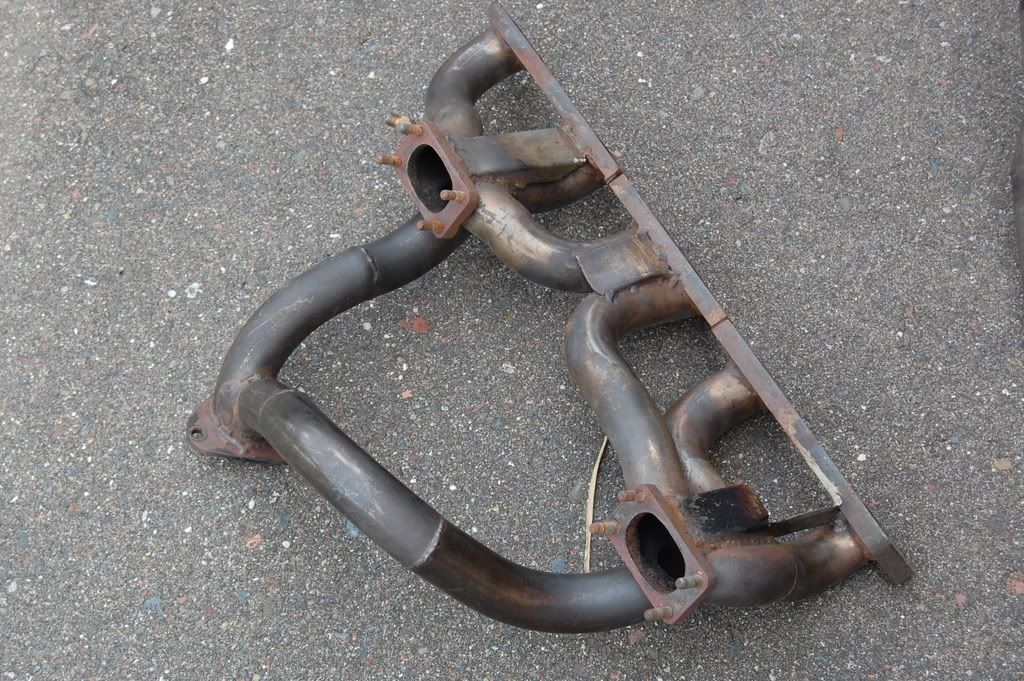

I would say no, due to seriously unequal runner length. If you were planning on replicating it, copy the back half where they're all a lot shorter and use that. It still wouldn't really be ideal but it'll be a lot better than that.

What seriously unequal runner length? The manifold runners are about equal in length. What you are looking at is the equivalent of the "downpipe" of a single turbo application. The "seriously unequal" pipes connect to the exhaust housing after the turbine.
It looks decent to me. I wish people would get off this equal length kick. The difference between the OEM manifold and ANY type turbo header is substantial. If you were designing an all out max power engine where 100% of every exhaust pulse is needed to achieve your power curve goals then yes, equal length is beneficial. Assuming the welds are good and the flanges seal, the big problem with this twin turbo header will be getting all the plumbing to fit. A/C is out for sure.
Main concern circled in yellow, that's nearly twice as long as several others. I provided an easy solution, simply copy the other grouping and use two of that style for the manifold. Btw, that's not the equivalent of a downpipe in any way shape or form, that's for the wastegate. Down pipes come off of the back of the turbos;-)

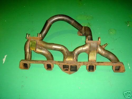

anyone notice the FLANGE is cut in two pieces?!
I can understand to prevent the manifold from warping due to uneven heating..
But damn.. one bolt to hold TWO exhaust runners on a flange and prevent leaking or a torn gasket?!

Actually the flange is 3 pieces, not 2! lol and NOT 1 bolt for each side, think bout it... there are 4 bolts to hold the outside runners on each side and then there are 3 bolts to hold the inside runners. Still takes 11 bolts just like a normal flange.
Now the crazy part is that the turbos mount under and the wastegate portion is the top of it. So I'm guessing depending on the size of w/g they use, it could and might very well be sticking out of the hood.
And yes, equal length header(s) are not extremely important in a street app. as mentioned, heck they are pretty close anyway and have to be routed like to that allow ample room for the 1st down pipe to squeeze in and possibly dodge the shock tower or steering rod? Also being tubular and routed nicely makes it way better than stock already. I'd say it's a pretty decent piece as long as the welds are good and it can handle the heat expansion/flexing.

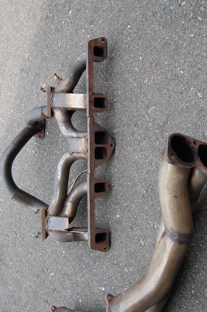

This is how it should look rotated properly and bolt holes outlined and #'d also, the yellow to show where the flange is separated...

Justin I meant to say the flange is cut in two *places*.. which would mean 3 total pieces.
The "washers" from the intake manifold to hold the flange down just worries me .. if not torqued to spec or the bolts become loose at all.. the flange will shift all over under the washer.
