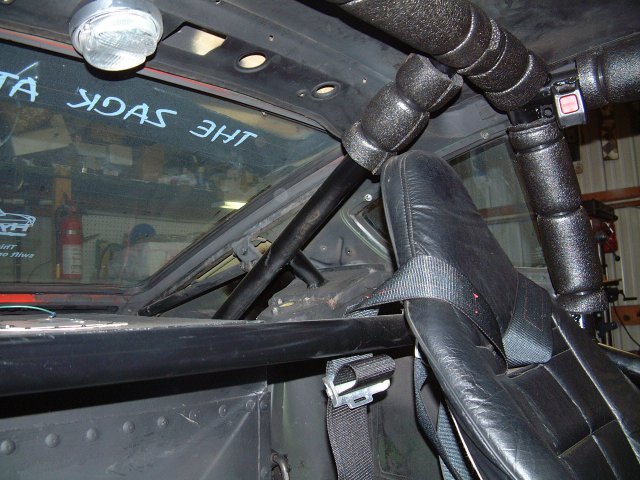

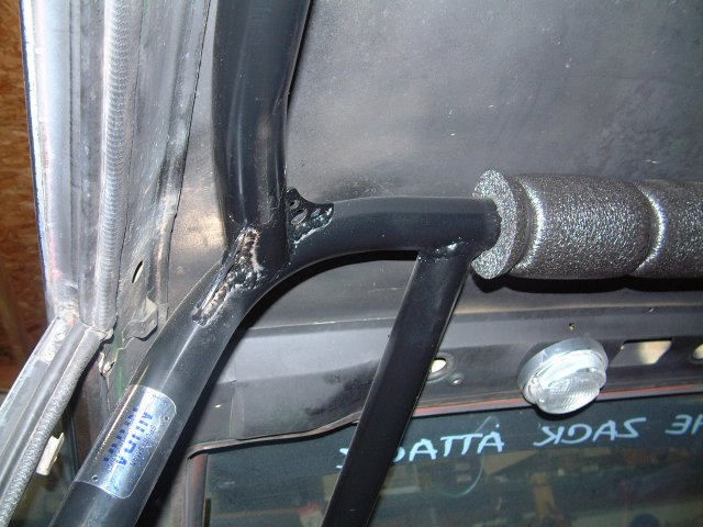

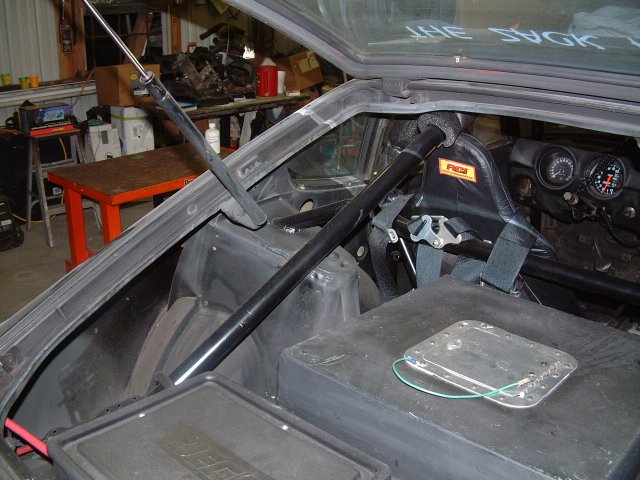

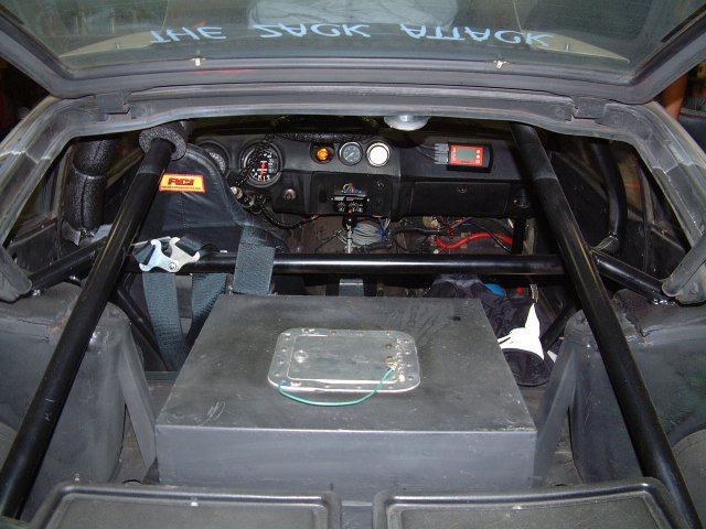

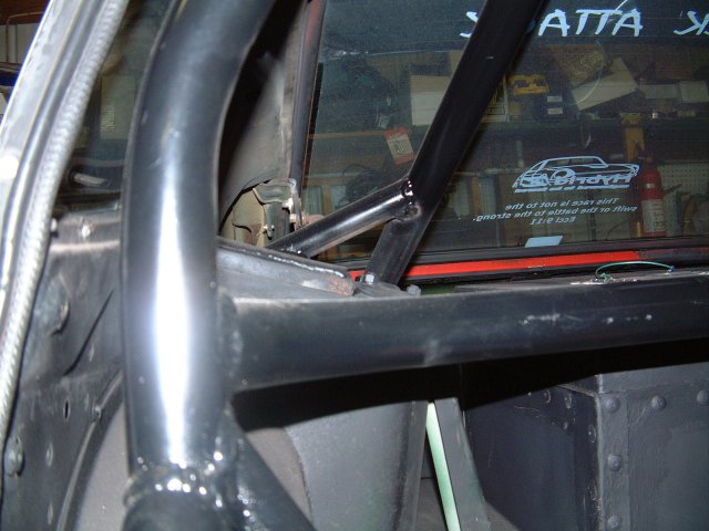

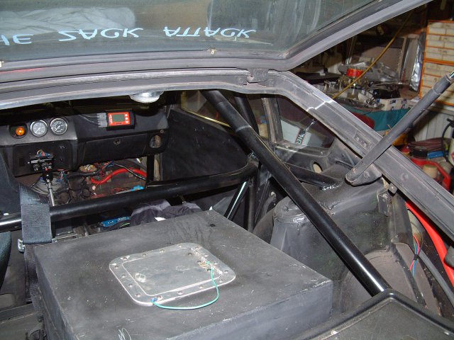

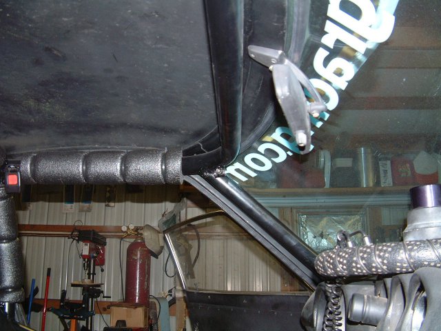

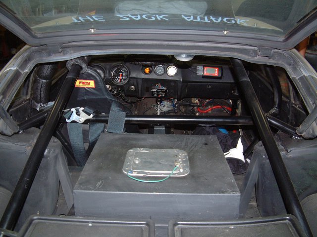

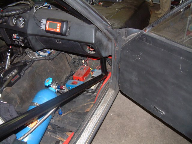

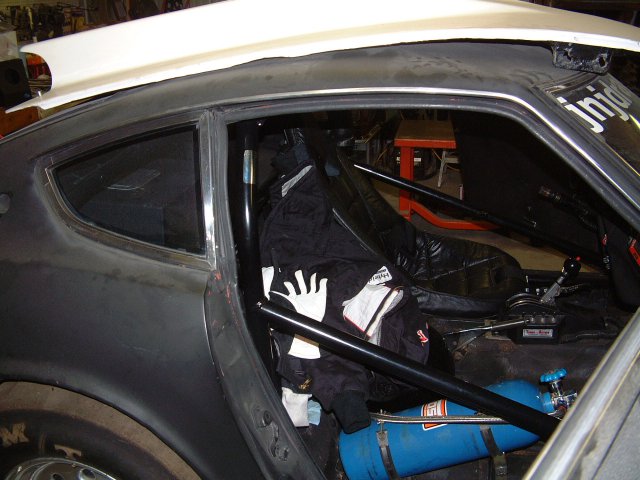

jnjdragracing Posted September 16, 2008 Share Posted September 16, 2008 Hey Ivan280zt, Sorry it took so long to take these for you but I have been busy and pulled in many ways. I hope it is not to late, but maybe you will get some ideas. The cage has been certified to 8.50 1/4 mile. John PS: the rear back bar behind the seats where the harnes bolts to was custom made, not jegs. Also the rear bars were custom made, only the hoop and window / dash bars were jegs. Quote Link to comment Share on other sites More sharing options...

MoNkEyT88 Posted September 16, 2008 Share Posted September 16, 2008 More pictures. Did you modify the bar behind the seat so you could move your seat back further? I have the 12 point jegster cage, and from what I can tell, the bar would just go straight between the main hoop. I'm 6'3" and would need the seat back further. Quote Link to comment Share on other sites More sharing options...
jnjdragracing Posted September 16, 2008 Share Posted September 16, 2008 Yes we did, we made our own bar. John Did you modify the bar behind the seat so you could move your seat back further? I have the 12 point jegster cage, and from what I can tell, the bar would just go straight between the main hoop. I'm 6'3" and would need the seat back further. Quote Link to comment Share on other sites More sharing options...
Ivan280zt Posted September 18, 2008 Author Share Posted September 18, 2008 John, hey bud thanks alot for the pictures that is what I was looking for. I am modifying my floor board so I can run my new Sparco seat and as soon as that is in place cage will be getting installed around it. Quote Link to comment Share on other sites More sharing options...

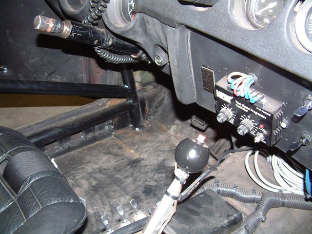

Slow_Old_Car Posted September 18, 2008 Share Posted September 18, 2008 JNJ what is that steering wheel release system your using? Quote Link to comment Share on other sites More sharing options...
jnjdragracing Posted September 18, 2008 Share Posted September 18, 2008 It is made by Moroso, it is just a quick disconnect. Since we are getting older and bigger around the belly we need it in order to remove the steering wheel so we can slip in the car because of the roll cage. John JNJ what is that steering wheel release system your using? Quote Link to comment Share on other sites More sharing options...
