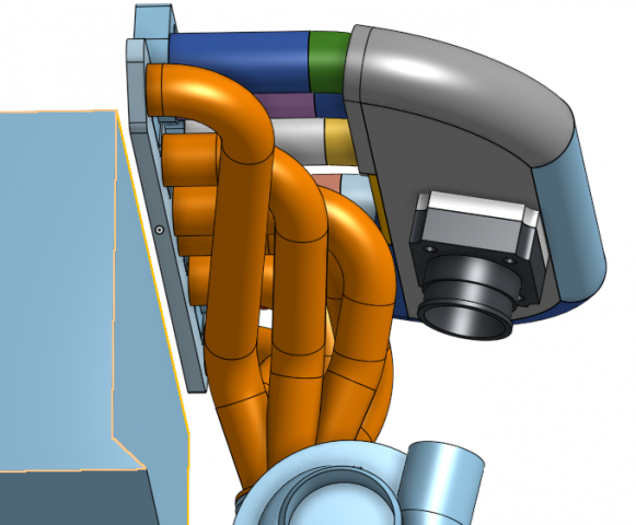

Gollum 28 Posted August 6, 2008 First: This is posted here because so many other intake manifold threads are here. Should this section get renamed to Air/Fuel Delivery? Ok, I've been kicking this idea around my head for a while now. This is my basic "sketch" I made to give a visual to what I'm going to say: I know this would have to be changed a bit to actually work, it's just a sketch. One of the most obvious things to me is there needs to be more straight material at the head so there's room for the manifold bolts. One of the main reasons I even thought of this idea, was a way to get around complicated intercooler piping. With this design you avoid needing to feet two intercooler pipes through one side, or running the far side around tight bends to be between the radiator and valve cover. I realize the runner length is insanely long, but I'm not sure that will really hurt performance THAT much. I myself don't plan on running a hot cam, or making power beyond 7k. In the long run I expect to still peak power aruond 5500-6k. This will be a street driven Z, and I don't want to ruin power at any RPM. If I do make this I hope to make it for under $300. I'll be using aluminum solder with a propane torch , and getting aluminum craps if I can. My budget GOAL is actually $200, but $300 is more of the expected budget. Another upside I was thinking about is that this gives you much easier access to the turbo, might also help keep the turbo a bit cooler giving it some extra space for air to move around. So... advice? Suggestions? Should I leave X amount of runner exposed inside the plenum or make it a smooth transition? Quote Share this post Link to post Share on other sites
TrumpetRhapsody 12 Posted August 6, 2008 Interesting design. Have you measured for hood clearance and such? What size runners are those? They seem a little small, but it might just be the perspective, or huge plenum. Might follow along if this ends up going well. Quote Share this post Link to post Share on other sites
Challenger 14 Posted August 6, 2008 Are you going to have a hood? Ive got a set of 180 aluminum elbows that would be perfect for this, has a flage on each end to bolt to the runners. I got it off of a BMW. Quote Share this post Link to post Share on other sites
Gollum 28 Posted August 6, 2008 Yea, hood clearence would be tight to say the least... I've been considering a lower and farther back engine placement if I do this, wich really adds some cost. $100+ for mounts $100+ for driveshaft shortening Those runners are.... 35mm? Lemme check... Yup, 35mm. Finding exact specs on the stock setup wasn't EASY. Though I didn't look too long I admit. At least I didn't start a thread asking for that info. The throttle is 60mm, and offset to the far side. I was thinking this should help eaven out the flow between cylinders a tad. EDIT: I take that back. Mount's should be that expensive. Just need to find some scrap metal around and buy a case of beer for the welder friend Quote Share this post Link to post Share on other sites
TrumpetRhapsody 12 Posted August 6, 2008 Dunno how much you could lower the engine (like seriously, I don't know haha), but it seems like the oil pan to front crossmember clearance is pretty close... Would be a good excuse to make solid mounts though if it works out. So you're going off of stock runner sizes, instead of increasing them for better flow? Just curious. Perhaps at the top section some of that oval flattened style tubing could be utilized. Another (likely bad) idea would be to cut semicircle notches out of the valve cover, and weld the tubing into them, uniting the valve cover and intake but giving more clearance. Probably would add heat soak though. Quote Share this post Link to post Share on other sites
Gollum 28 Posted August 6, 2008 Oval tubing is more expensive and harder to find. I'm honestly not sure how large the stock runner diameter is. Lemme see what I can dig up real quick. I'm not going to be porting the head, so I'm not sure how much benefit there would be to increasing the runner diameter. Oh, and from looking at JohnC's pictures of his race car there's plenty of room to go down and back. Quote Share this post Link to post Share on other sites

ZROSSA 0 Posted August 6, 2008 Looks like the runners on my 79 635csi. The bmw guys seem to prefer the later style manifolds for making more power. Probably due to the position of the throttle body. When they turbo this engine the best performers have the inlet manifols set up more like the traditional nissan one. I dont think you will gain much if anything. What you make up for in intercooling pipe you lose in manifold pipe and probably throttle responce. Douglas Quote Share this post Link to post Share on other sites
Gollum 28 Posted August 6, 2008 Yea, I realize the overall length would be about the same. It's just a simpler/cleaner setup in my eyes. I've also considered making my own manifold that just stays on the driver's side, just means getting an intercooler with the inlet and outlet on the same side, and figuring out how to fit them through the core support. Quote Share this post Link to post Share on other sites

TimZ 22 Posted August 7, 2008 I know this would have to be changed a bit to actually work, it's just a sketch. One of the most obvious things to me is there needs to be more straight material at the head so there's room for the manifold bolts. The Mikuni-tyle ITB manifolds have virtually no room for bolts, either - you can always use studs instead. One of the main reasons I even thought of this idea, was a way to get around complicated intercooler piping. With this design you avoid needing to feet two intercooler pipes through one side, or running the far side around tight bends to be between the radiator and valve cover. It's an interesting thought - am I interpreting this correctly that the manifold plenum would actually be on the passenger side of the engine (US passengers, that is)? If so, you are going to want to incorporate some sort of quick release mechanism so that you can still get to the valve cover for things like valve adjustments, etc. Take a look at Monzster's Wiggins clamp arrangement on his manifold for instance - there are some less expensive options you could use, such a v-band clamps. I realize the runner length is insanely long, but I'm not sure that will really hurt performance THAT much. I myself don't plan on running a hot cam, or making power beyond 7k. In the long run I expect to still peak power aruond 5500-6k. This will be a street driven Z, and I don't want to ruin power at any RPM. One thing you might consider - since you are going this far out of the box, it might be good to think about using a symmetrical plenum design to get more even flow distribution to the cylinders - think 5 liter Mustang manifolds. Also, didn't somebody just do something similar with a diesel manifold? , and getting aluminum craps if I can. Sounds painful Another upside I was thinking about is that this gives you much easier access to the turbo, might also help keep the turbo a bit cooler giving it some extra space for air to move around. It would also give you less exposure to exhaust manifold heat - if you did the quick release thing above, you might be able to get by with something trick like carbon fiber for the passenger side bits. So... advice? Suggestions? Should I leave X amount of runner exposed inside the plenum or make it a smooth transition? Monzter did a post in the early stages of his manifold development that looked into runner transition designs - that would be a good place to start. Quote Share this post Link to post Share on other sites
Gollum 28 Posted August 7, 2008 Thanks for the insight Tim!!! I meant scraps... boy I got a good chuckle out of that this morning. You've assumed correctly though. The plenum would be on the passanger (left hand drive) side of the vehicle, opposite side of the inlets. I know the runner length LOOKS really long, but idealy the plenum would hug the valve cover really well to keep the distances short. Quote Share this post Link to post Share on other sites

OlderThanMe 76 Posted August 7, 2008 OMG Tim!!!! lol Gollum, for a N/A motor, long nuners are good for torque. Have you figured out the helmholtz numbers for your peak pressure? It wouldn't be that hard to make a variable intake with a design like that........ two plenums etc... Quote Share this post Link to post Share on other sites
Gollum 28 Posted August 7, 2008 Wow, I'd forgotten about that commercial. Man that's funny. OTM - This will be turbo, so I'm not sure how much runner length affects power, other than throttle responce. And no I havn't calculated the helmholtz yet... Not even sure how honestly. Quote Share this post Link to post Share on other sites
OlderThanMe 76 Posted August 7, 2008 Proxlamus posted this link in his ITB fabrication thread... http://www.velocity-of-sound.com/velocity_of_sound/calculator3.htm Quote Share this post Link to post Share on other sites

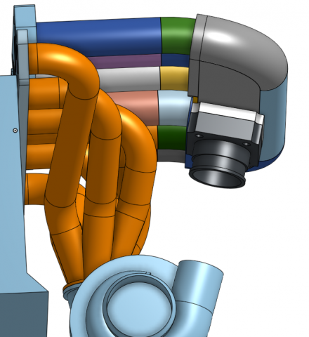

Gollum 28 Posted August 7, 2008 Here's the plenum after some slight revisions. Shorter straight length, a bit more radius added. I added the fuel rail for visual purposes, just to get an idea of what it'd look like. I'm wondering what it would take to use a stock manifold as a base for this.... Would bring down costs. Wouldn't have to buy one of blake's flanges, or make my own. The clamp idea seems pretty cool tim, but I'm wondering if I might end up with sealing issues if I go too cheap on them. That's a lot of clamps that will need to make pretty good seals. Quote Share this post Link to post Share on other sites

Gollum 28 Posted August 7, 2008 Proxlamus posted this link in his ITB fabrication thread...http://www.velocity-of-sound.com/velocity_of_sound/calculator3.htm Thanks for the link. I'm getting a result of 19.44". My design is 21.7" in the last picture if I've made my calculations right. Quote Share this post Link to post Share on other sites
