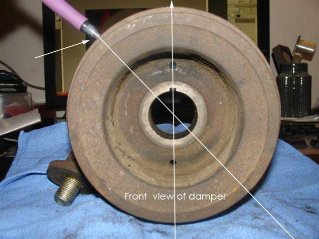

I'm not sure what your asking but the hub adapter will only fit the stock damper like this one.
I'm trying to find out the relationship between the 2) 1/4-20 puller bolts and the timing marks over the various hubs.
Ideally knowing the relationship between the keyway, timing mark and 1/4 20 bolts. would be great.
I'm trying to get this info so I can make these as close to a plug and play as I can get.
Thanks

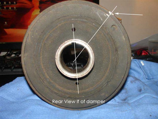

Derek, looking at the damper from the front my timing mark is on the left or passengers side.
If I turn the damper on the horizontal plane 180 degrees counter clockwise and take a picture of the backside of the damper then the timing mark will be on the right. Maybe that's were the confusion was.
I think my damper is just like yours.

Just to prove I'm not stoned.
This is going to complicate things for some (all) of you. It appears my sensor holder bolts on to where your timing indicators currently mount. This is going to make your install a bit trickier. Your going to have to rig a timing indicator on the drivers side.
Here's the way it would work. Install hub adapter and 36-1 wheel. Set the timing indicator on 10 deg btdc. Make a timing pointer out of stiff wire (temporary) or out of sheet stock. Mount it in one of the holes that my indicator mounts to. Make a mark on the damper where the pointer is. This is now 10 deg. btdc (limp mode). Install sensor, align 36-1 wheel, check timing at new mark.
I'll add this to my install instructions with a little better detail.

I was talking about a ring that would fit on your dampener that had marks liek this, rather than 36...
See This dampener has only 12 notches out of it. I think the timing mark is about 35 degrees from the crankshaft key, but I would need to verify this. real similar to DJ's rear view pict.
