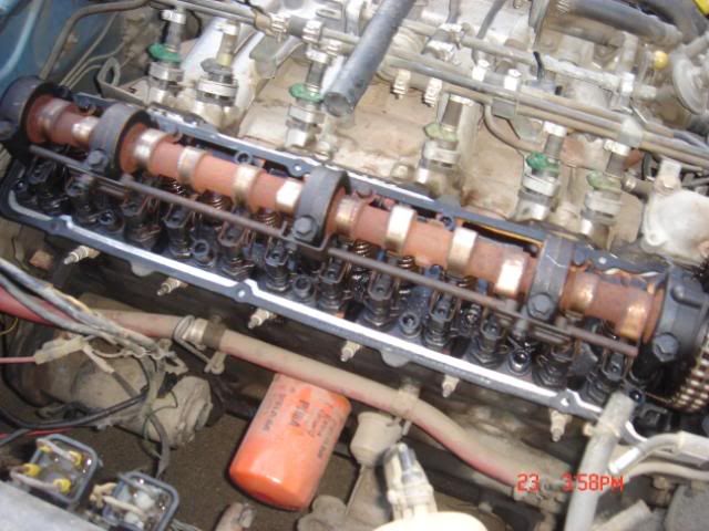

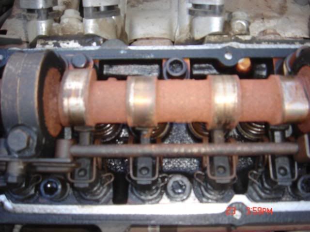

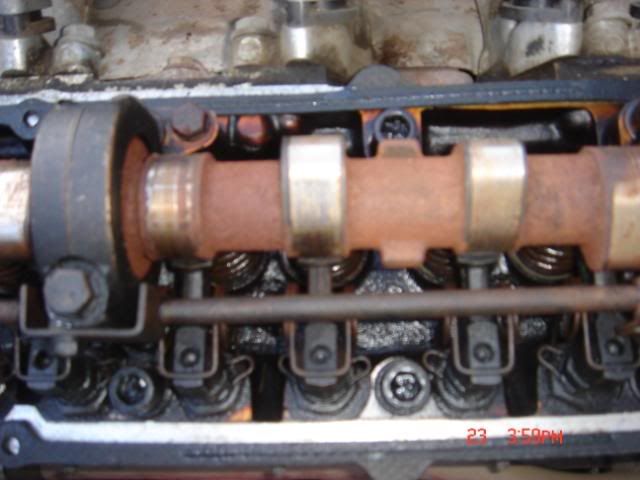

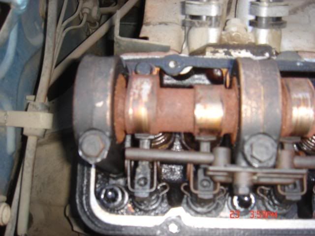

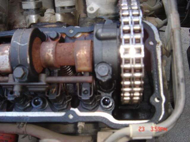

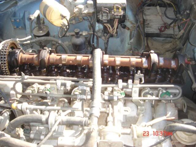

RaDeuX Posted November 23, 2008 Author Share Posted November 23, 2008 Oh geez, so my parents want the 280Z to be gone out of the house. I had no idea you can't park a non-op vehicle on the driveway. But I've been told that you need a proof of registration for anyone to take your car away for you. I don't have the pink slip from Kismet yet, but I do have the bill for the transfer. As long as he doesn't send me the pink slip until the Z is functional nobody can send it to the landfill/demolition center right? I hope that's the case. Kismet pick up your phone!! Okay so I took off the head cover (whatever you call it) and it looks okay with a bit of rust. I guess I'm going to have to take that part off too, and then post more pics when I'm done with that. I'm getting one of my friends and my brother to push the car into the garage soon. Hopefully it'll stay there until the engine starts up Quote Link to comment Share on other sites More sharing options...

deja Posted November 23, 2008 Share Posted November 23, 2008 Yikes! Unless that pic just doesn't show it there apears to be NO oil in the head at all resilting in a rusted cam. Is there any oil in the engine? Will it turn over? Pull the plugs and try tuning it by hand. When was the last time the engine ran? Looks like you have some work to do to get that running at all. Good luck, I don't think its going to be a simple fix. Quote Link to comment Share on other sites More sharing options...
