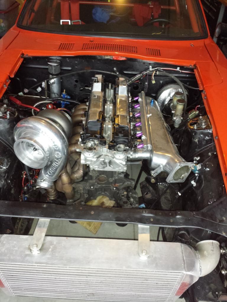

Ivan280zt Posted December 24, 2014 Author Share Posted December 24, 2014 (edited) I have been having small boost creep issue that was bothering me so instead of just turning the boost up (basically bandaid fix) I decided to add second 46mm Precision wastegate to fix that problem for good! I had to split vacuum lines for each WG Second dumptube fab Still need to add bracket to reduce vibration of second dumptube -3an ss lines hooked up Now I just need to hook up Nos kit and it should be ready for another dyno session. Edited December 24, 2014 by Ivan280zt Quote Link to comment Share on other sites More sharing options...
