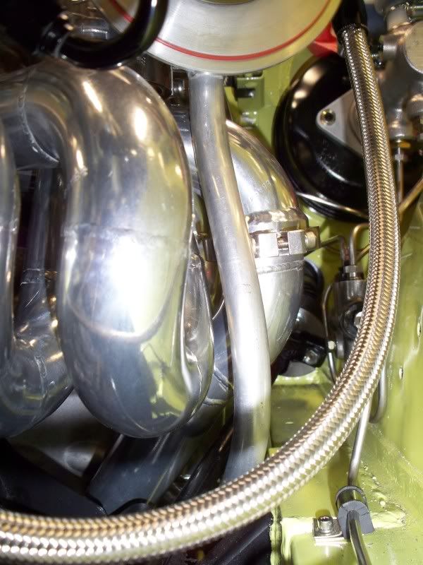

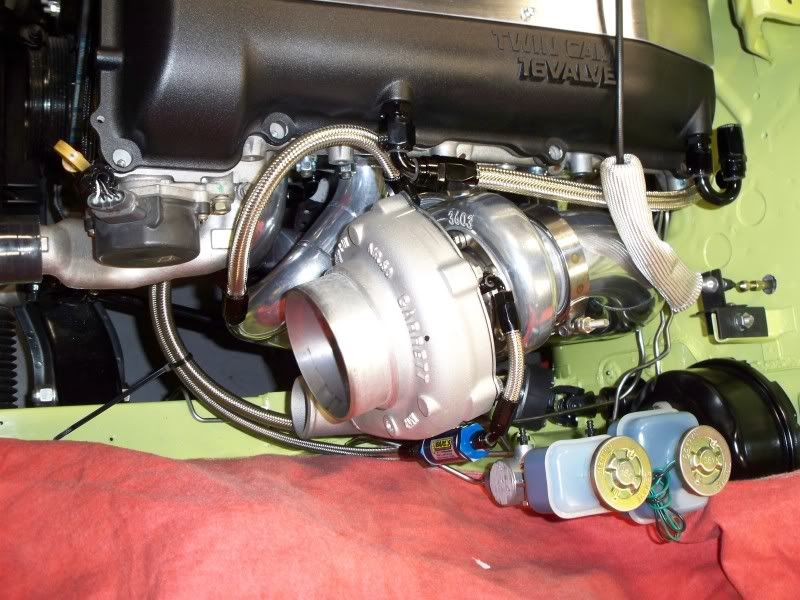

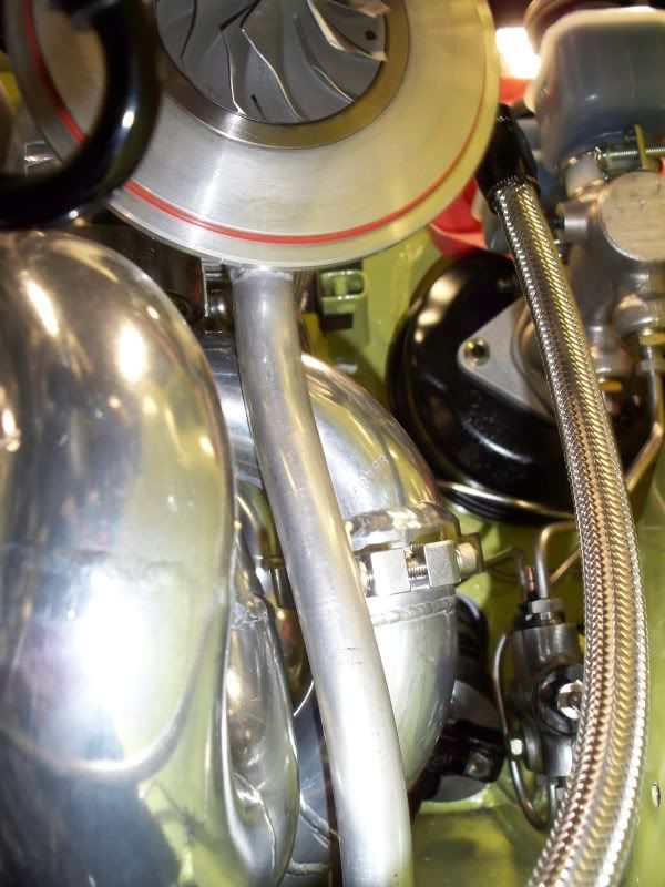

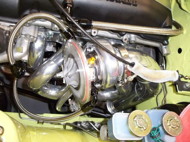

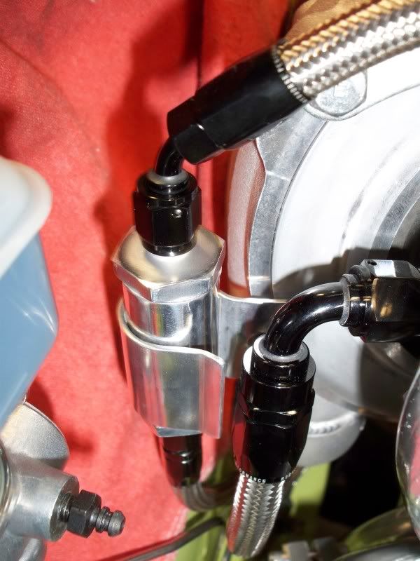

Zed@National Speed Posted December 29, 2009 Share Posted December 29, 2009 Cobra_Tim said: Looks great man! Shouldn't the oil return be pointed directly down though? Or is that a cooling line I see? The oiling axis of the turbocharger (i.e. oil-feed and oil-return axis) is perfectly vertical. If you look at the pictures again, the gold fitting is the restrictor fitting for the oil-feed inlet of the turbocharger. The line you're thinking of is the water-return line (I assume). Here are two clear pictures of the oil-return hard line... Here you can see the oil-restrictor fitting for the oil-feed inlet... All water and oil lines assembled... (the inline-oil filter did not stay blue) This is how the inline-oil filter looks now, polished, with a custom polished aluminum filter stay bracket... Quote Link to comment Share on other sites More sharing options...

cygnusx1 Posted December 30, 2009 Share Posted December 30, 2009 I would re-route the throttle cable which might require a linkage redesign. Call me anal, but the cable resting on the downpipe in an otherwise perfectly thought out ride, makes me itch to redesign. The sock will probably work but...I don't mean to sound like an armchair QB, but that missing detail bugs me in such a perfect car. Quote Link to comment Share on other sites More sharing options...
jt1 Posted December 30, 2009 Share Posted December 30, 2009 Are you using the inline filter on the turbo feed as an extra precaution to protect the turbo, or is it because the oil feed is unfiltered? jt Quote Link to comment Share on other sites More sharing options...
Zed@National Speed Posted December 30, 2009 Share Posted December 30, 2009 Blakt Out said: FYI, that dude is the lead badass on the team of badasses building this car. I asked him to watch this forum in case there were any questions he could help anyone with. I'm really impressed with them. Check out their website. Not a silly solicitation, but really. They turbo anything and it works, and they have the nicest shop I've ever been in, and the guys know their stuff better than I can actually believe. So many times, even now, I ask Jordan or Taylor or Chris... three guys on my car, how in the world they learned all this stuff! Thanks Jared, we do greatly appreciate the kind words. I'm glad you made it back safe, by the way! cygnusx1 said: I would re-route the throttle cable which might require a linkage redesign. Call me anal, but the cable resting on the downpipe in an otherwise perfectly thought out ride, makes me itch to redesign. The sock will probably work but...I don't mean to sound like an armchair QB, but that missing detail bugs me in such a perfect car. Agreed. Unfortunately, the only 36" throttle cable I can find with a 90degree provision in the base, is for a Harley Davidson, and we're not 100% that it will work. There have to be other options out there, it's a matter of calling each company to see what's available. The company we normally use for throttle cables and accessories is Lokar, but unfortunately they are closed for the Holidays until Monday, 01.04.10. My searchs on automotive aftermarket search engines hasn't been fruitful thus far. The fire sleeve is good for a continuous exposure of 1,200degree F conditions. See the product information here, it's designed for spark plug wires, such as an LSX in which the spark plug wires are awfully close to the header primary, even stock. It will work until a 90degree throttle cable can be procured. Good input though, I agree 110% with you! jt1 said: Are you using the inline filter on the turbo feed as an extra precaution to protect the turbo, or is it because the oil feed is unfiltered? jt The oil feed is from the factory location (the oil-feed 12mm x 1.25TP location) that we have adapted for -AN accommodations. The only place this oil is filtered, is at the main engine-oil filter. We do not completely trust that, and would rather protect the non-rebuildable dual-ball bearing CHRA (Center Housing Rotating Assembly, i.e. industry standard for "center section") from any debris. If you've ever seen the opening for a Garrett dual-ball bearing restrictor fitting, you'll know how insanely small the opening is. It wouldn't take much to clog it, then... Well... Jared's got a $500 CHRA exchange to deal with. So to avoid that, the inline oil filter is a nice safe guard against contamination of the CHRA. Quote Link to comment Share on other sites More sharing options...
RB26powered74zcar Posted December 30, 2009 Share Posted December 30, 2009 Not sure if you have seen this thread yet, but it would solve this cable hick-up perfectly... Here is the thread> http://forums.hybridz.org/showthread.php?t=147601 Quote Link to comment Share on other sites More sharing options...
