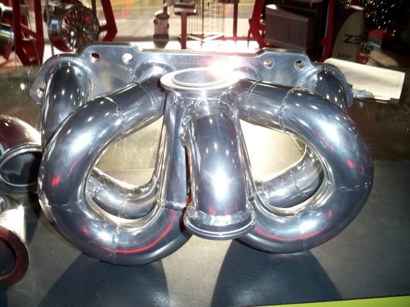

I Like how you have it all TIG welded I just hope you're not paying to much for this exhaust, these welds are Amateur at best. These guys might be great at other things but the welder needs to go back to school. Like I said I hope your not paying Top Shelf Price here
What's wrong with the welds?
This is exhaust after all, cosmetics should be the last concern. That said, I'm thinking all of those welds look pretty legit. If you must dissect it, the only irregularities are where they overlap because the complex shapes were spot welded first and then closed up afterwards, but the heat and penetration are apparent, there's no real indication that they could be weak or contain any leaks. Sure you can tell it's been done by hand, but they are very even and consistent nonetheless. If you think those welds are sub par then you must be really spoiled imo...

It probably looks very good to a person that never welded for a living. Well My professions is a Pipe Welder and If i TIG welded like that guy they probably would tell me to pack my ♥♥♥♥ and go home. One of the other major thing I noticed that he did not capped off the ends and feed the stainless piping with Argon which will cause it to "Sugar up" It basically will give you bad penetration which can cause your exhaust to crack at the welds.
Also if you haven't already done this mod, I would have your Stainless headers Ceramic coat them because when stainless gets hot it loves to crack.
So if it should ever crack at the welds later down the road, he better not charge you. Not trying to be negative nancy cause I totally envy your car, just giving you an opinion on these welds as a pipe welder.
