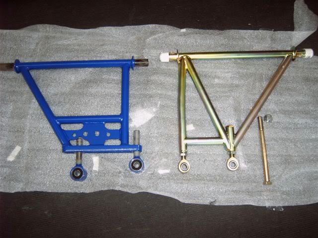

On the rear arms, I must've mistyped something. I actually bought BOTH the AZC & the Modern Motorsports arms. (Can you say, OVERKILL?) I wanted to really evaluate which I thought was best.
Here's the pic. The MM one is blue. The AZC is just the chromoly. We put the AZC on, so if someone wants the MM ones, I have those ready to ship!

The AZC website show billet 6061T-6 aluminum control arms like the front. I didn't realize they had a chromoly version. Did you have to fashion a mount for the rear sway bar? In one shot I thought I saw the links taped to the control arm.
I bought mine before the billets came out. Might swap later on. The diff mount has holes for the sway bar to go through. Is that what you're talking about?
I think he's referring to the holes on the rear control arms themselves for the end links (like what the MM arms have).

I thought the control arms had mounting points for the sway bar. I see where the SB is mounted to the diff mount. On AZC's website the SB connection to the rear control arm is present on the billet control arm and in one of the pics with the full install the rear sway bar can be seen to mount to the control arm. 1) why did you choose the AZC over MM arms and 2) Are camber plates necessary in the rear or can camber be adjusted adequately with the arms?

Gotcha. I'll have to look at that. Not doing the work myself, other than small bits. I bought this car to do myself, and it got out of hand and I got busy. Didn't want to slow down the time that it'd take me to get it, and I wanted the quality to be better than I could deliver myself.

I chose the AZC arms because they looked nicer, honestly. The bottom of the car has been just as important to me on the fit and finish as the top. I don't know if camber plates on the rear are necessary. I just did them while we had the car apart. Since I haven't gotten it down on the ground to really play with the suspension, I can't answer that.
