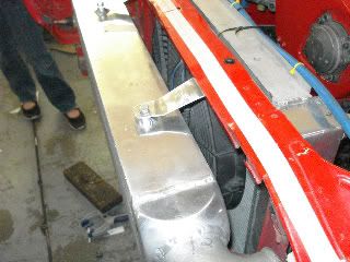

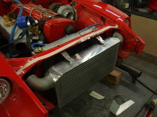

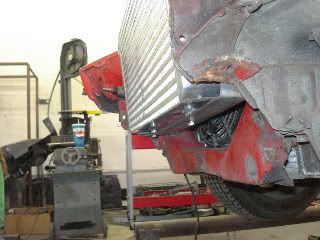

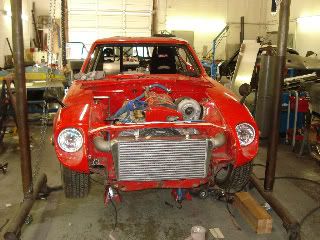

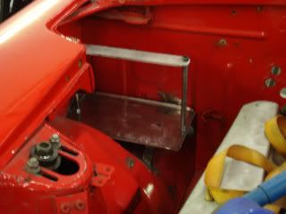

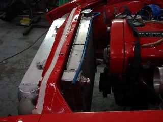

stony Posted May 28, 2009 Author Share Posted May 28, 2009 Little update. With the lack of room in the back i decided to put the battery back in the original location. the stock frame rails are now tied into the cage floor, and the intercooler radiator and motor are all mounted. by the end of the week should have the floor sheetmetal done. I'm headed to alabama for school for 6 weeks so i should be ready for pickup when i get back Quote Link to comment Share on other sites More sharing options...
MREDDLE Posted May 28, 2009 Share Posted May 28, 2009 Very nice build... What size AN fitting are you using for your radiator? Quote Link to comment Share on other sites More sharing options...
getoffmyinternet Posted May 28, 2009 Share Posted May 28, 2009 Holy crap! Any idea what it will do to weight etc? Quote Link to comment Share on other sites More sharing options...
stony Posted May 28, 2009 Author Share Posted May 28, 2009 16 AN for the 2 normal ones and a -12 for teh swirl pot return Should be 2100lbs +/- 1-200 lbs Quote Link to comment Share on other sites More sharing options...
