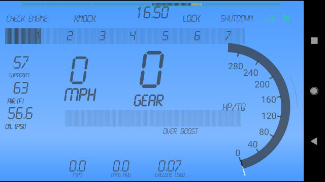

Gollum Posted January 20, 2019 Author Share Posted January 20, 2019 Definitely more foraging than forging. I'm not regretting having megasquirt, but I'd definitely make a different choice the second time around. That said, today was a pretty product low key garage day. I now have my flex fuel sensor installed though my wiring isn't final (just wanted to make sure it works). Also got my new IAT bung welded on. Tomorrow I think I'm going to make a run to the parts store so I can sort out my vacuum lines a bit better, as well as maybe find some steel tube to allow me to add my new bypass valve. I also spent some time working on my accel enrichment curve and now it's much more responsive with throttle stabs. Not perfect, but I need my VE table to be more solid before I fuss much more. And in case you didn't see it elsewhere: I was thinking I'd just cut the whole thing out, but I don't want to grind around down there too much with the tank in place, but then I realized I can just drill out the spot welds. Might tackle that tomorrow. We'll see. I know eventually, possibly next winter, I'll be installing a fuel cell so anything I do now is just temporary until I have a final floor placement with a cell in place. A small side note: Though goof off is primarily acetone, it's definitely FAR better at removing dynamat TAR. By a lot. It's also only $2/gal more at my local Lowes. Quote Link to comment Share on other sites More sharing options...

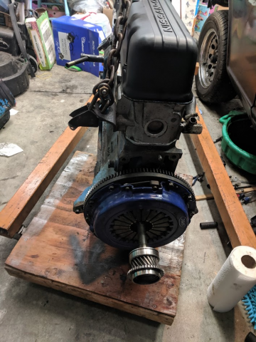

stupid_fast Posted August 24, 2019 Share Posted August 24, 2019 (edited) Other than a bit of a mishap installing the rear main seal, Gollum's new loaner motor ready to go. I dropped it off earlier today. Came out of a 240z in running condition that my buddies doing a v8 swap on. Had a pair of SU's and a points dizzy on it! To my surprise it was a P90/F54. Put front & rear seals and replaced the valve stem seals, installed an A cam and a newer OSK timing sprocket from my engine while I was at it. Looks like a clean original turbo motor, but there is evidence the timing chain has been changed at some point. Should be a good runner for Gollum to get some seat time while he collects parts for his swap. Edited August 24, 2019 by stupid_fast Quote Link to comment Share on other sites More sharing options...

Gollum Posted August 27, 2019 Author Share Posted August 27, 2019 New motor arrived (thanks stupid_fast!) along with a baller clutch alignment tool. 😀 Will try my best to get the motor buttoned up and back in the car by Thursday. Going camping for the long weekend, and will then have next week and weekend to get her fired up and rolling around again. Quote Link to comment Share on other sites More sharing options...
