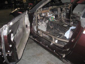

SR240Z Posted May 13, 2009 Author Share Posted May 13, 2009 In the beginning I didnt mention that this project is all happening thanks to Daryl Alison from JustDriven.com Roll cage is done!!! Gussets galore up in this *****. Oh and now the doors are completely gutted and cut out Here are the pics: Quote Link to comment Share on other sites More sharing options...
