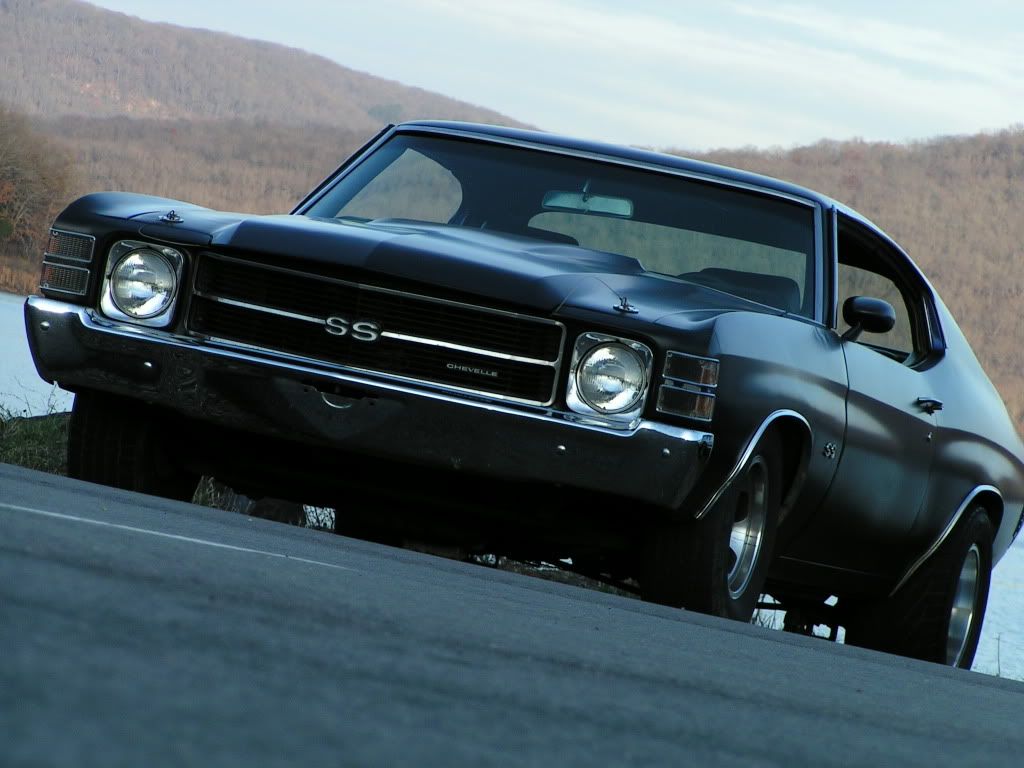

FlatBlack Posted November 23, 2009 Author Share Posted November 23, 2009 Looks like I haven't updated this in a while. Swapped clutches last weekend, made a bad decision on the clutch and it slips worst than the first one. Lesson learned, ordering a new clutch very soon, hopefully can have it in after Thanksgiving but before Finals hit. I've had a serious power-plant life changing event this weekend. This is my buddy Kevin's 70 Chevelle SS. I have known him for a while but I hadn't had the time to ride in it until this weekend. It is an LS1 with a mild cam, FAST intake, a tune, and a 4L60E. He is dynoing a bit under 400WHP IIRC. Anyways, he got on it and I about soiled myself. So, I have until next Spring to decide what to do. I'd like to see what I can get out of the turbo L28, but with the LSX so readily available, [And my next project after the turbo car is 'finished' will be an LS3 S30], why not start collecting parts for a LSX build? Got to think long and hard about this one. If I decide to pull more out of the L28 next summer, it'll be a bigger turbo and meth injection, and possibly another rebuilt Flat Top F54/P90 with a thicker HG. Quote Link to comment Share on other sites More sharing options...
