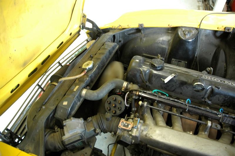

Administrators BRAAP Posted October 4, 2009 Administrators Share Posted October 4, 2009 As the title says... ...No photchop, no trickery, no goofen, actual photo taken today. Quote Link to comment Share on other sites More sharing options...
capt_furious Posted October 4, 2009 Share Posted October 4, 2009 ...methinks there are individual coils hiding somewhere behind that running engine w/ no plug wires. Quote Link to comment Share on other sites More sharing options...
auxilary Posted October 4, 2009 Share Posted October 4, 2009 oh crap, I didn't get a chance to call you. tomorrow morning and it's running tec2 electromotive on the other side of hte block. dizzy is for show Quote Link to comment Share on other sites More sharing options...
garvice Posted October 4, 2009 Share Posted October 4, 2009 Dam, I was too slow to post. I have a cad file for a distributor cover if you want it. Not saying your incapable, seen through your posts that your more then capable, just thought it could make it quicker. Quote Link to comment Share on other sites More sharing options...
eec564 Posted October 4, 2009 Share Posted October 4, 2009 The real problem is there's an AFM still in the intake plumbing. COP certainly isn't a problem. Quote Link to comment Share on other sites More sharing options...
B00STDZ Posted October 4, 2009 Share Posted October 4, 2009 AFM backwards? Quote Link to comment Share on other sites More sharing options...
evil_datto Posted October 4, 2009 Share Posted October 4, 2009 I would say the no wires on the dizzy till I realized must be COP. AFM is fine... The only thing I could possibly see is the thing on top of the TB? Quote Link to comment Share on other sites More sharing options...
MoNkEyT88 Posted October 4, 2009 Share Posted October 4, 2009 No LSX motor. Quote Link to comment Share on other sites More sharing options...
280zx 2by2 Posted October 4, 2009 Share Posted October 4, 2009 Vtec not kicking in? Quote Link to comment Share on other sites More sharing options...
turboHLS30 Posted October 4, 2009 Share Posted October 4, 2009 280zx 2by2 said: Vtec not kicking in? Dang you got to it before i did LOL Quote Link to comment Share on other sites More sharing options...
trwebb26 Posted October 4, 2009 Share Posted October 4, 2009 TPS bolt come loose? It looks a little crooked. Quote Link to comment Share on other sites More sharing options...
FlatBlack Posted October 4, 2009 Share Posted October 4, 2009 How is the fuel rail getting fuel, It looks like the lines go under the manifold?? I'm also confused about the AFM... Quote Link to comment Share on other sites More sharing options...
thrustnut Posted October 4, 2009 Share Posted October 4, 2009 It's pretty obvious the fan clutch is bad...duh! My buddy is a VW guy and allot of them us MS and the stock dizzy as a plug Quote Link to comment Share on other sites More sharing options...
Administrators BRAAP Posted October 4, 2009 Author Administrators Share Posted October 4, 2009 (edited) I love this forum! you guys don't miss a thing. Car is a '73 240, belongs to customer turned friend. I wwapped out his carbed L24 for an L28 and installed the factory '75 EFI, cleaned up his N47 manifold, EGR delete, etc, been running for approx 3-4 years in that config. Running engine without plug wires was the question, but you guys also found a couple more good ones. 1) RTz had just installed a WOLF Engine management system on the car and got it running and with nice coarse tune over the last few days. 6 GM LSx coils just under the spark plugs. The Turbo Dizzy is being used for the optical sensor. I'm sure Rich will eventually build a cover, though I personally like the WTF factor it has now. 2) The AFM is still physically in the air flow path but not being used electrically. Rich (the owner of the car), will take care of replacing the AFM with intake pipe/tubing. Edited October 4, 2009 by BRAAP ERROR! Quote Link to comment Share on other sites More sharing options...
