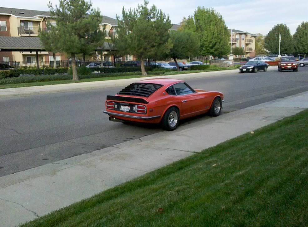

Sketch_hs Posted October 20, 2010 Author Share Posted October 20, 2010 (edited) Outside my shop this morning, almost 200 miles on the swap. Running great! Finally found the right belt. It's a 6 rib 983mm belt Works great for not running PS or AC. Tach is working. Removed inline resistor and wired it directly to stock signal wire. Pretty accurate, with in 200 rpms at redline. Videos soon! Edited October 21, 2010 by Sketch_hs Quote Link to comment Share on other sites More sharing options...

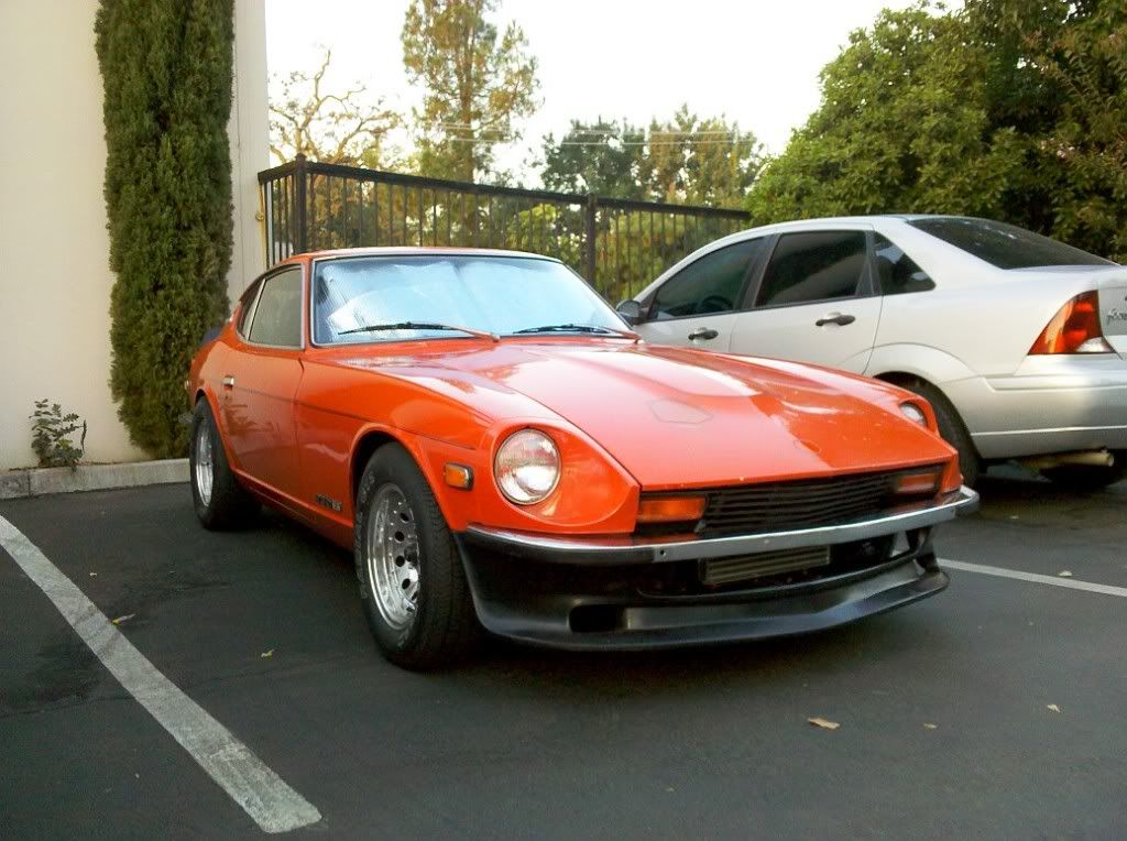

Pharaohabq Posted October 20, 2010 Share Posted October 20, 2010 Which front skirt is that? Did you have to modify much to put on the 240z bumpers with it? Sorry, I didn't realize you'd said Venus Automotive earlier, I had just read 8 pages. phar Quote Link to comment Share on other sites More sharing options...
Sketch_hs Posted October 21, 2010 Author Share Posted October 21, 2010 On 10/20/2010 at 10:50 PM, Pharaohabq said: Which front skirt is that? Did you have to modify much to put on the 240z bumpers with it? Sorry, I didn't realize you'd said Venus Automotive earlier, I had just read 8 pages. phar I bought it used (actually traded) I think it's the MSA or something, defiantly urethane. The 240 bumpers just needed simple brackets made. Quote Link to comment Share on other sites More sharing options...

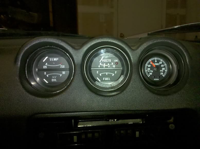

Sketch_hs Posted November 1, 2010 Author Share Posted November 1, 2010 Drove it about 250 miles this weekend! Running great Did a boost gauge install. Gutted the broken clock and inserted a VDO boost gauge. Matches the rest of the gauges in it's style and lights up green like the stock gauges, though a bit brighter. Boosting a solid 11-12psi. Feels very quick! Quote Link to comment Share on other sites More sharing options...

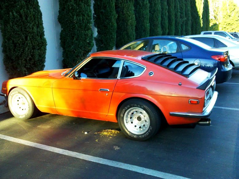

Sketch_hs Posted November 5, 2010 Author Share Posted November 5, 2010 Another pic, looked great in person. Too bad the camera phone captured it a little blurry: Videos will be coming very soon. Quote Link to comment Share on other sites More sharing options...

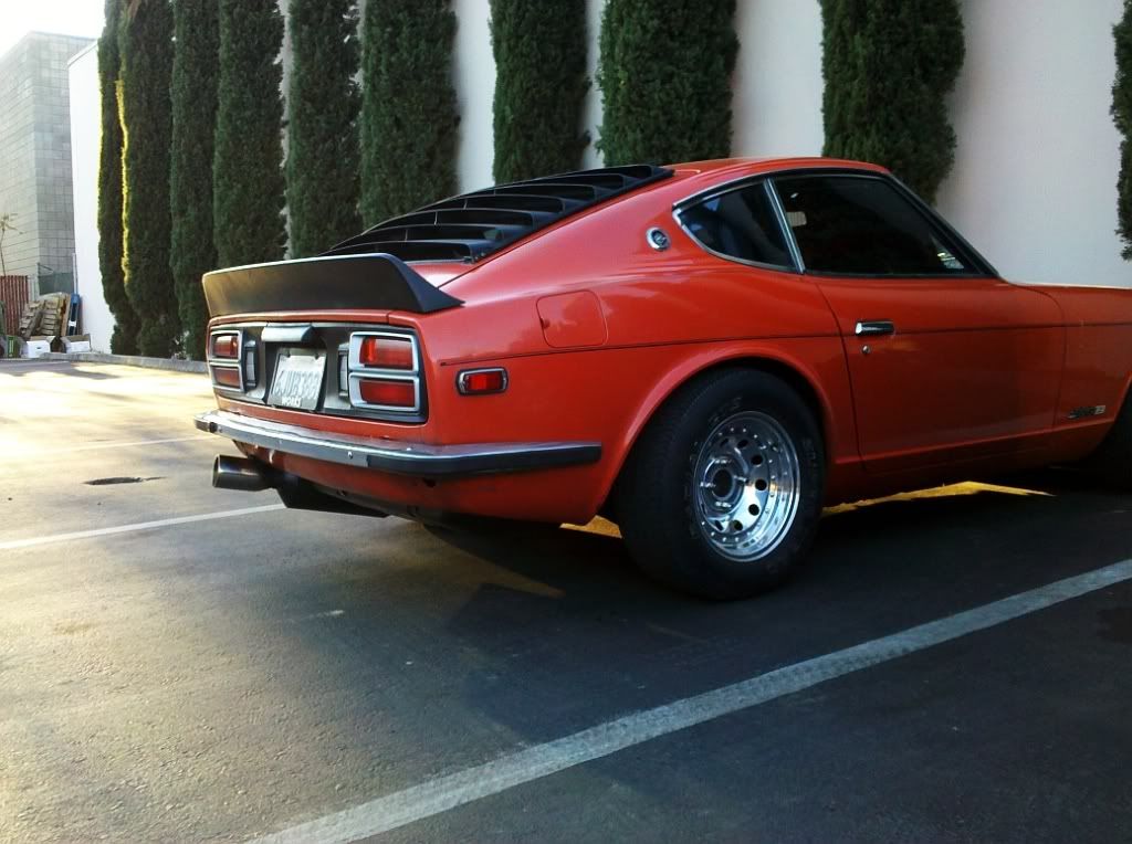

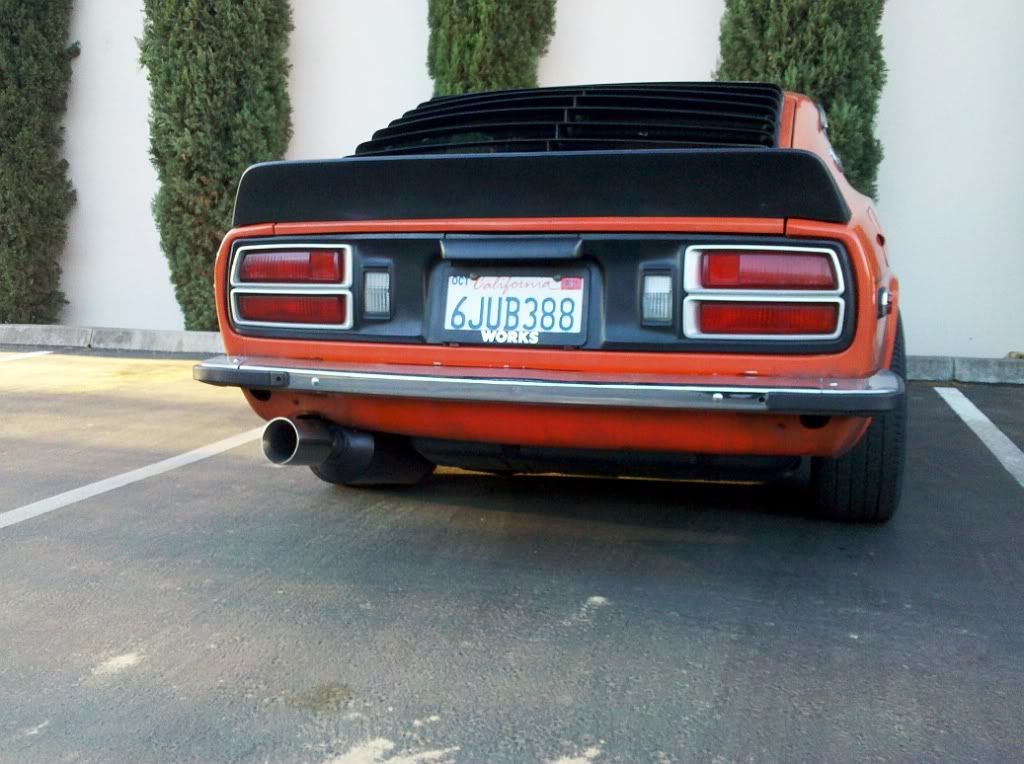

Sketch_hs Posted November 17, 2010 Author Share Posted November 17, 2010 Pics of current exhaust setup. Was able to push this muffler in further by putting a nice dent in the rear corner of the can. Then I painted the can with high temp mat black. Very happy with the noise reduction. It's very quiet now, the sound of the turbos sucking in air is what you mostly hear until high RPMs when it really sings. No loss of power that I can feel. This is all foreplay anyways until I build a nice 3 inch system. It's going be be hard though because the 2 incher is already pretty low hanging in some parts.... Quote Link to comment Share on other sites More sharing options...
