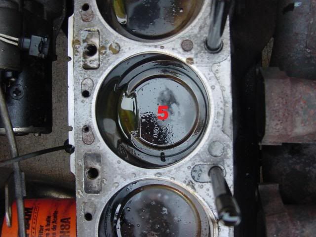

jc052685 Posted January 3, 2010 Author Share Posted January 3, 2010 If nothing else answers you problem. Did it blow in the identical spot? stupid answer but have you checked for warpage or a crack in your head in that spot? I think I already stated it but.... it is a fresh head this time around as the last time it melted the deck between 3 and 4. But is is back and running so yeah, I took some pics of the gasket and it blew the side out of number 5. Quote Link to comment Share on other sites More sharing options...

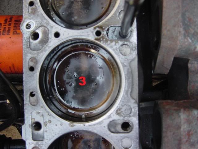

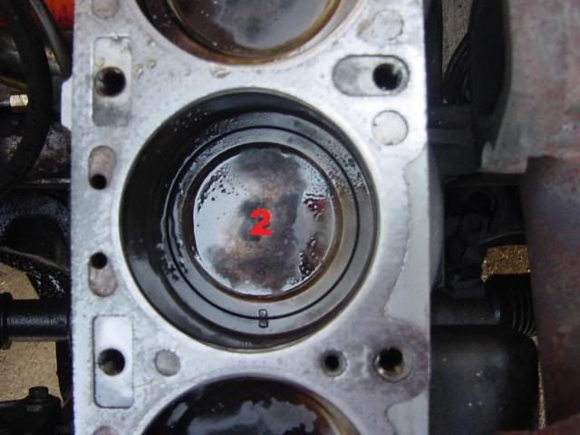

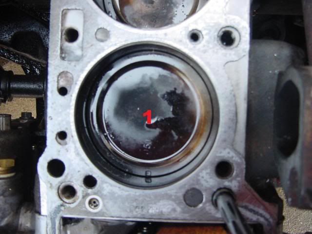

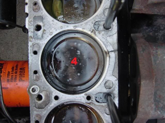

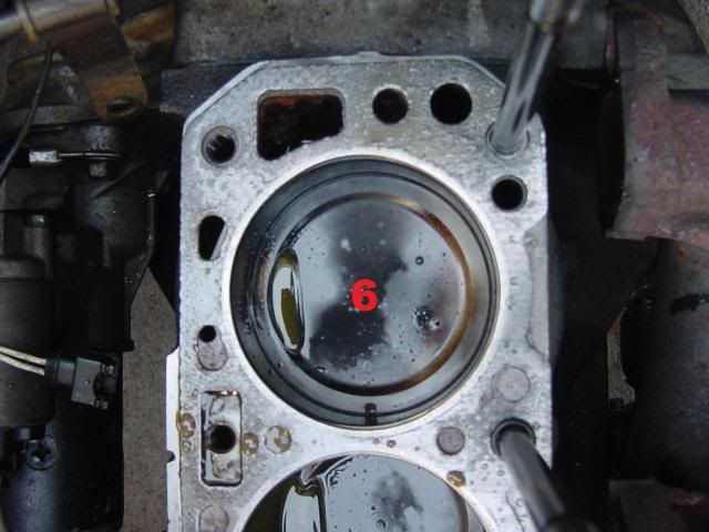

jc052685 Posted January 6, 2010 Author Share Posted January 6, 2010 Ok. the pics of the last gasket failure that made it 3-4 miles and one 2nd gear pull. Quote Link to comment Share on other sites More sharing options...

Xnke Posted January 6, 2010 Share Posted January 6, 2010 Look at your gasket bores. ALL of them are ovaled, you are detonating. Pull 5 degrees of timing, and try again. Quote Link to comment Share on other sites More sharing options...

jc052685 Posted January 6, 2010 Author Share Posted January 6, 2010 Look at your gasket bores. ALL of them are ovaled, you are detonating. Pull 5 degrees of timing, and try again. Gasket was ovaled before it went on the car..... Quote Link to comment Share on other sites More sharing options...
