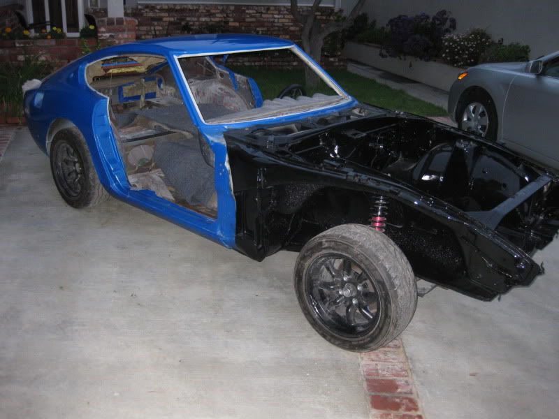

It's been a while since i last updated mainly because it's been just as long since i really did any significant work on my car but i finally put a good few hours into it yesterday and damn it felt good to work on it.
in the last few months i have slowly repaired all of the rust in my engine bay and the wheel wells.
next week if work does get to hectic i will be shooting it with POR15. I didn't know this but you can primer directly over POR15 without sanding. So i have been told and read.
Anyone have any experience with this?
I was thinking about shooting the POR15 on the floors and inside at the same time if time permits.
I was also thinking about maybe just stopping after the por15 and keeping it the gray color of the POR15. Time is not on my side anymore with 50 to 60 hours of work a week so this would definitely speed up completing the project.

Back in business.
here are some updates.

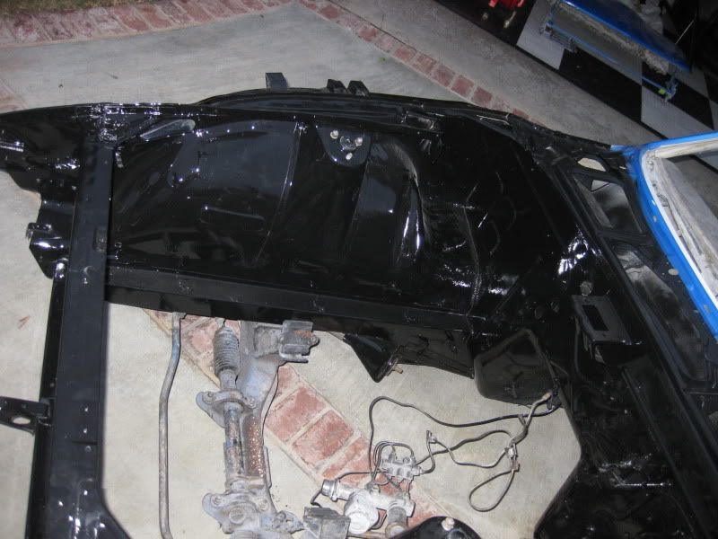

Finished all Rust repair in the engine bay, trans bay and wheel wells. I pulled off the entire front suspension and had the car sitting on jack stands and shot both the bay and wheel wells at the same time.
Shot the entire bay and wheel wells with POR15. Surprisingly it shot easily reduced NO MORE then 5%, the finish reminds me of powder coating and made rust repair so much easier.
I used a scotch bright and wire wheel with most of the rust.
Didn't have to worry about getting it to bare metal because this stuff sticks better to rust.
Used a D/A on the rest of the bay.
Took a wire wheel and brush to the wheels well.
Prepped all of the metal and Sprayed!
a few second video i found when i first brought it home after paint...this is Pre Color Sanding
So Shinny!
