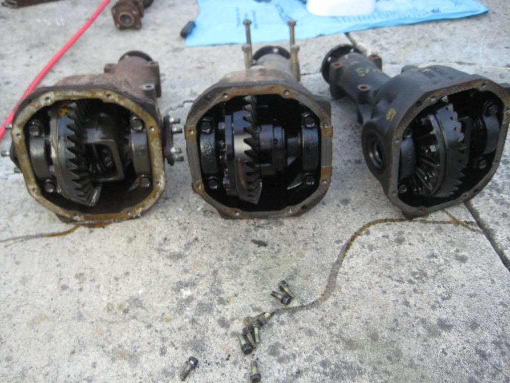

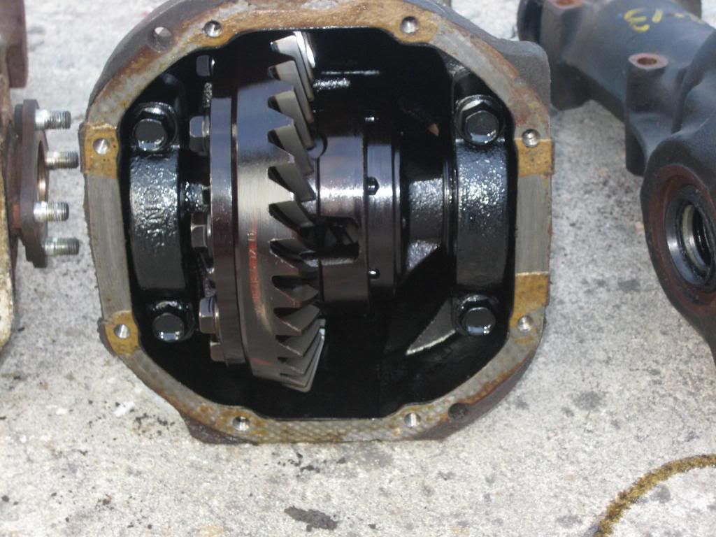

JMortensen Posted February 19, 2010 Share Posted February 19, 2010 The 4 pinion open diff has to have a closed carrier because the cross pin is shaped like a + unlike an open carrier which has a crosspin shaped like a | If you have the | shaped carrier you put a spider gear at either end and have a surface to locate the side gears, and the rest of the carrier can be an open window. A 4 pinion doesn't give you that option, the carrier has to bolt together like this one does in order to house 4 pinions inside and it ends up looking like a clutch LSD. The CLSD has an angled cross pin shaft. It doesn't really look like the VLSD either: Quote Link to comment Share on other sites More sharing options...
ben280zx Posted February 19, 2010 Share Posted February 19, 2010 I was mistaken for an lsd as well. See these pictures, it look very close to the lsd but like Jon pointed out its 4 pinion. Quote Link to comment Share on other sites More sharing options...
