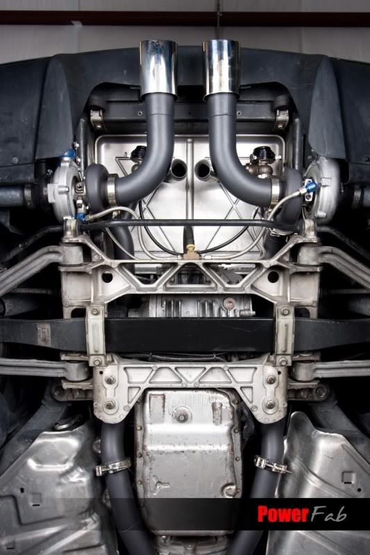

Not sure why you would be scarred to throw boost at a LS motor. Local shop twin turboed a LS2 c6 automatic vette. Motor and tranny all stock. Made over 640whp on 10 or 12 psi.
