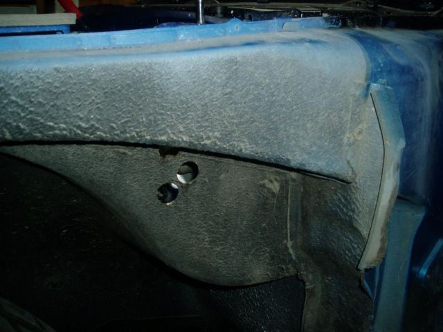

Bartman Posted September 22, 2010 Share Posted September 22, 2010 So I've been having ongoing problems with cooling on my Z. I've made several changes over the years and it works fairly well until it gets really hot (over 90 degrees or so) and I use my A/C. The other day I test drove my car around my neighborhood on a hot day with the A/C on and sure enough it eventually starting running hot. I pulled into my driveway and kept it running with the A/C on and the hood opened. It started cooling down almost immediately and went back to normal operating temperature, so I figured that I need to find a way to get the air out of my engine compartment. I don't have a vented hood, but I do have vents in my fenders, so I'm thinking I should hook up fans and make them functional. So I pulled one of my fenders and am looking at a couple of fans I already have laying around. It would take considerable amount of work to make these fit, or maybe I can find some smaller ones. So I'm just throwing this idea out there to see if anyone has any input on. Here's a few pic's: Quote Link to comment Share on other sites More sharing options...

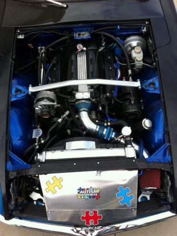

Bartman Posted September 22, 2010 Author Share Posted September 22, 2010 I have an airbox to the radiator and it doesn't seem to make much difference. I seem to have plenty of air getting through the radiator, but not enough hot air leaving the engine bay. I've thought about inspection lid venting, but since I have fender vents already it seems to make sense to try and use them to rid the engine bay of heat. Quote Link to comment Share on other sites More sharing options...
hoov100 Posted September 22, 2010 Share Posted September 22, 2010 (edited) I have an airbox to the radiator and it doesn't seem to make much difference. I seem to have plenty of air getting through the radiator, but not enough hot air leaving the engine bay. I've thought about inspection lid venting, but since I have fender vents already it seems to make sense to try and use them to rid the engine bay of heat. Did you connect the fender vents to the engine bay? The problem with most street setups is that once the air enters the radiator and into the engine bay is has nowhere to go, but under the car which would create and area of low pressure (?) which would cause the high pressure air (?) going around the car to be sucked into the engine bay. Edited September 22, 2010 by hoov100 Quote Link to comment Share on other sites More sharing options...

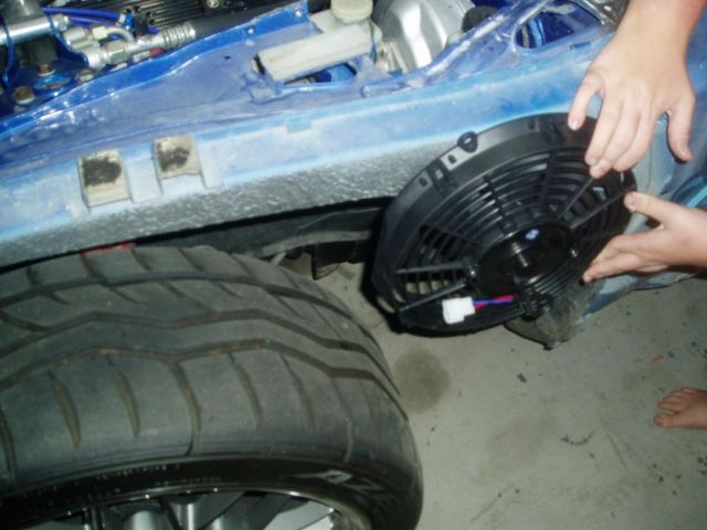

Bartman Posted September 22, 2010 Author Share Posted September 22, 2010 Have you looked here http://forums.hybridz.org/index.php?showforum=47 Yes, I have and I've even posted my radiator ducting with pictures...but no reply. I'm looking for specific information regarding venting hot air out of the engine bay like what cygnusx1 posted (thanks cygnusx1). I'll probably just move forward with this experiment, it's just a matter of determining the best size fans to use. Quote Link to comment Share on other sites More sharing options...
GOTHALOSISM Posted September 22, 2010 Share Posted September 22, 2010 Why not use some 120mm Computer fans? They should be small enough to fit inside and yet still move enough air. Quote Link to comment Share on other sites More sharing options...
Pharaohabq Posted September 22, 2010 Share Posted September 22, 2010 Another more stealthy option is to make firewall vents to your cowel area. This way the air is pulled from the top of the engion and out across your windshield. It helps lower the pressure in your engine compartment too. All without affecting that beautiful paint job you have. YOU might also consider opening up the vent holes in your wheel well to the fender vents, since those look pretty small to me. Think about the volume of air you need to exhaust, then the size of your vent holes. Now do you see your trouble? Holes about the size of his inspection lid vents would really help. I'd recommend the Cowel Vents tho they might affect your AC when not on Recirc since the Cabin air intake is also in the cowel. Phar Quote Link to comment Share on other sites More sharing options...
Bartman Posted September 22, 2010 Author Share Posted September 22, 2010 Computer fans may work, in fact I seem to remember a post on some other site that did just that - but don't they need to be changed to run on 12V? Venting out the cowl may work, but my cowl panel isn't vented and my outer fender already is, so all I should need to do is add more venting and a fan to the inner fender to move lots of air. I won't be messing with my exterior at all. Quote Link to comment Share on other sites More sharing options...
Bartman Posted September 22, 2010 Author Share Posted September 22, 2010 (edited) Why not use some 120mm Computer fans? They should be small enough to fit inside and yet still move enough air. I guess computer fans actually use 12V, so this may be a great solution. I've even found 250mm fans that move over 105 CFM! 250mm fan. I think your correct with the 120mm fans being easier to fit, so I'll probably give them a try. Edited September 22, 2010 by Bartman Quote Link to comment Share on other sites More sharing options...

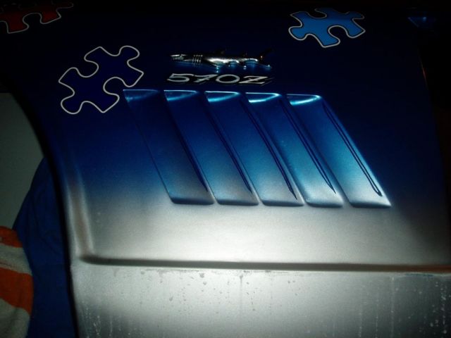

Pharaohabq Posted September 22, 2010 Share Posted September 22, 2010 Wow, no Cowel vents, that's interresting... So yeah okay, out the side then... You'll need to make sure you get waterproof fans like these since regular computer fans won't hold up. you should also include a fuse on that circuit just in case. Nice Side vents btw, Were they expensive to have put in? Quote Link to comment Share on other sites More sharing options...
Bartman Posted September 22, 2010 Author Share Posted September 22, 2010 My cowl panel is fiberglass with a carbon fiber layer on top and I installed the fender vents myself. This Spal fan may just be the ticket since it is small, moves a good amount of air, and is waterproof: Spal 4" fan Quote Link to comment Share on other sites More sharing options...

Bartman Posted September 26, 2010 Author Share Posted September 26, 2010 So I got the Spal 4" fans I mentioned in my last post and went ahead and set one in place. I think I will fill in the couple of vent holes I made previously, but here's a couple of pic's showing what I'm planning. I also added a piece of wire mesh to the inside to prevent debris from getting kicked by the tire into the fan blade. Quote Link to comment Share on other sites More sharing options...
cygnusx1 Posted September 26, 2010 Share Posted September 26, 2010 (edited)  That should flow plenty of air judging by the size of the hole.  It will at least cool the engine bay, hopefully even help the radiator. Edited September 26, 2010 by cygnusx1 Quote Link to comment Share on other sites More sharing options...

Bartman Posted April 4, 2011 Author Share Posted April 4, 2011 So the fans seem to be working well when the car is stopped or moving slow. It was till running a little hot at speed, so I finally completed some aluminum ducting forcing air through the radiator. Although it hasn't been too hot yet, I think I may finally have this issue resolved! Quote Link to comment Share on other sites More sharing options...
