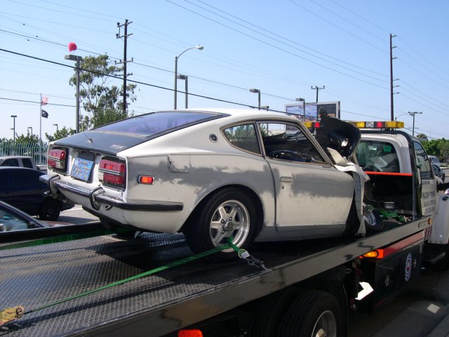

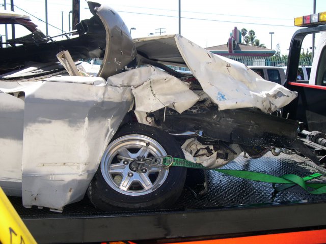

Tony D Posted December 9, 2010 Share Posted December 9, 2010 "Most of us take off the heavier 260/280 bumpers. How much difference do those really make in a higher speed accident?" 70+ mph into the back of a free-rolling Dodge Neon going ZERO mph? A LOT OF DIFFERENCE! It was the difference between wrapping the entire engine into the firewall due to no absorption and spreading of the impact (look at the 240 I posted earlier) and being able to simply jerk the front end back straight and continue racing for another 7 hours. I don't know about you, but hitting a stationary car full-rearend at 70mph is pretty high speed in my book. And the bumper was not damaged! It sprung back out. And in fact was the anchor point for my F250 to jerk the front end back relatively straight. The radiator was the crush-zone that absorbed the final bits of energy. Into a solid reinforced concrete wall at 70mph? Maybe a moot point there. But in practical application: taking those off is colossally stupid from a safety standpoint! Quote Link to comment Share on other sites More sharing options...

Pharaohabq Posted December 9, 2010 Share Posted December 9, 2010 "Most of us take off the heavier 260/280 bumpers. How much difference do those really make in a higher speed accident?" 70+ mph into the back of a free-rolling Dodge Neon going ZERO mph? A LOT OF DIFFERENCE! It was the difference between wrapping the entire engine into the firewall due to no absorption and spreading of the impact (look at the 240 I posted earlier) and being able to simply jerk the front end back straight and continue racing for another 7 hours. I don't know about you, but hitting a stationary car full-rearend at 70mph is pretty high speed in my book. And the bumper was not damaged! It sprung back out. And in fact was the anchor point for my F250 to jerk the front end back relatively straight. The radiator was the crush-zone that absorbed the final bits of energy. Into a solid reinforced concrete wall at 70mph? Maybe a moot point there. But in practical application: taking those off is colossally stupid from a safety standpoint! I certainly see your Point. So we'll add that to the list: 6: Don't remove Factory bumpers. How about the idea of reenforcing the earlier flimsy 240Z bumpers with a strip of solid steel? hidden behind the 240Z bumper. Yeah we wouldn't have the shock absorbers, unless we drilled and mounted a set far enough back for nicer spacing with the bumpers. A solid steel backer might allow for more impact transference to the frame. front and back would likely add 100Lbs. Quote Link to comment Share on other sites More sharing options...

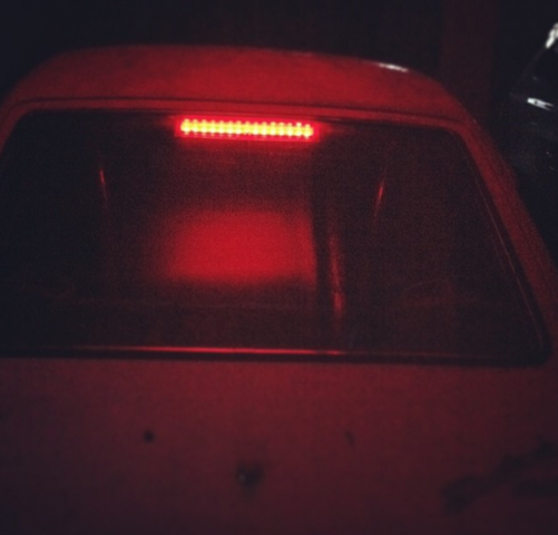

bjhines Posted December 9, 2010 Share Posted December 9, 2010 (edited) heheh.. I thought of a few more things. A marker flag on a 4' tall flexi pole would aid in finding the little cars in parking lots(full of 7 foot tall suburban assault vehicles). A 3rd brakelight mounted on the roof(as high as possible so it is visible through the windsheilds 2 SUVs back). Train horns http://trainhorns.net/ DRL foglights and driving lights. Replace the fatory seatbelts. Only 5 years lifetime for sanctioned racing, Why would anyone rely on the antique Datsun seatbelts. Door reinforcement. Already mentioned, later years are better. Full chassis reinforcements without a cage. Check out the head-safe cage with roof reinforcements http://www.modified.com/features/0611sccp_opera_performance_nissan_350z/index.html or the S2000 http://www.modified.com/features/0611sscp_opera_performance_honda_s2000/index.html Floor/footwell reinforcements, This is something I have seen discussed before... John C. ??? Edited December 10, 2010 by bjhines Quote Link to comment Share on other sites More sharing options...
