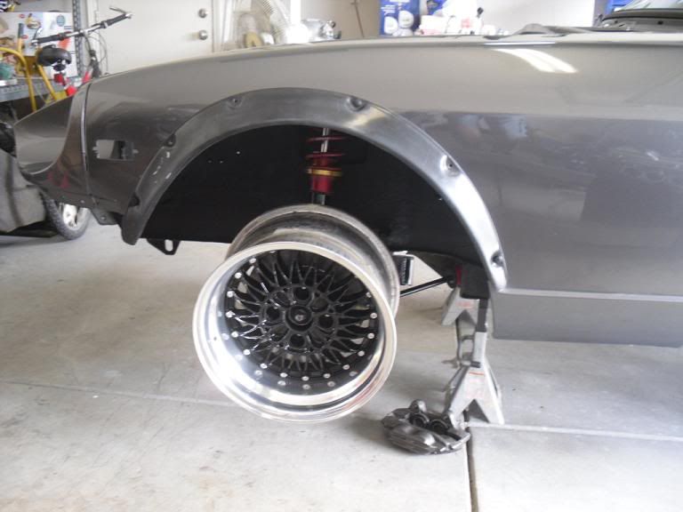

piston Posted January 27, 2011 Share Posted January 27, 2011 (edited) Thers really no need to complain to them because that's the only molds they have and like some mention above, from knock offs to knock offs, it starts to change shape. All it requires is drill your holes first, hold up the fender, mark your holes, drill, then put them on. I got mine from zcarparts and it needed a bit of flex to work. The best way I found and seen other members do it on here is line the two top holes up with the body line, then flex the edges inwards towards the wheel well curves. These sat 1 inch away from wheel well before flex, it actually sticks out a bit more and give it a better stance after flex. Edited January 27, 2011 by piston Quote Link to comment Share on other sites More sharing options...
stav2201 Posted January 27, 2011 Author Share Posted January 27, 2011 Sweet, thanks for the advice and visual. I just need to figure out how much more fender to cut off and how low i can place the flares since im going with th 17x9 Rota RbR's in the front. The rears prove to be a little more difficult, im just not sure how low i can place the flares before they start rubbing against the tires in the rear. Any advice fellas? Quote Link to comment Share on other sites More sharing options...
