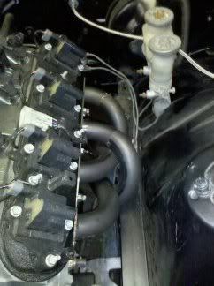

1 tuff z Posted June 24, 2011 Author Share Posted June 24, 2011 update-driver or left side prototype looks nearly complete, saw a pic this morning and will post [actually sunnyz will] soon. question for you guru's on frame rail dimensions for both 240 & 280. are the length, distance between and such the same on the frame rails from 240 through 280? i ask as the fabricator has one of the tubes fairly close to the frame rail on sunnyz's 280 and wanted to ensure it won't pose any issues when installed on a 240. i'm fairly confident they are the same but wanted to confirm. thanks, david Quote Link to comment Share on other sites More sharing options...
SUNNY Z Posted June 24, 2011 Share Posted June 24, 2011 As promised: Quote Link to comment Share on other sites More sharing options...

1 tuff z Posted July 1, 2011 Author Share Posted July 1, 2011 builder called me today. both prototype sides are complete [in mild steel] and meet all requirements except; a/t trans and removal of headers to pull trans. i just paypal'd him funds to purchase the stainless materials to build the ss prototypes, once complete we'll post pics in this thread. next steps; pay for ss materials [done], order ss materials to build ss prototypes [in process], build ss proto's, provide builder contact info for buyers [us] to clarify/place orders & provide deposit, build ss longtubes, ship ss longtubes! builder estimates about 2 weeks until the ss protos are completed. so, get your paypal accounts ready all! Quote Link to comment Share on other sites More sharing options...

mpramsey Posted July 9, 2011 Share Posted July 9, 2011 As much as I dont want to, I need to remove myself from the header build list. I installed a Subaru PS rack along with a TransAm steering shaft. I routed all of my steering linkages straight down and atop the drivers side frame rail. After looking at the pictures I have little doubt that I will have interference issues between the steering linkages and the header tubes as they loop out and over the frame rail. I will just utilize the block huggers that I have currently installed. My 1978 LSx 280Z is off to the exhaust shop monday for a 3" mandrel bent exhaust. Once installed the car will be brought to LG Motorsports in Wylie, TX for a dyno tune. I will snap some pictures and post once the exhaust is complete! Sorry I could not follow through with this. Quote Link to comment Share on other sites More sharing options...
