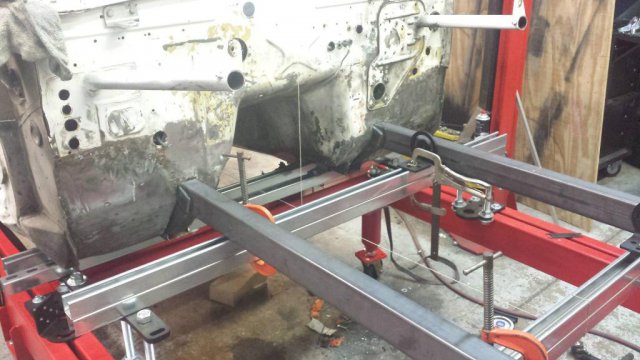

cobramatt Posted February 5, 2014 Author Share Posted February 5, 2014 Construction of the front clip has begun. Car is on the jig and all the geometry has been calculated and designed in a CAD program. I will now have wheel hubs and bearings like a real race car and not that of a riding lawn mower....... Quote Link to comment Share on other sites More sharing options...

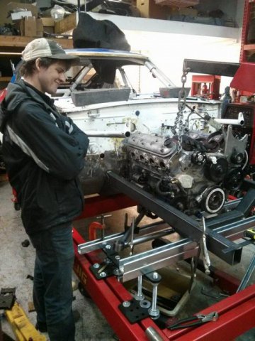

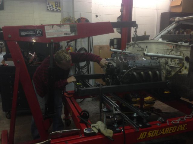

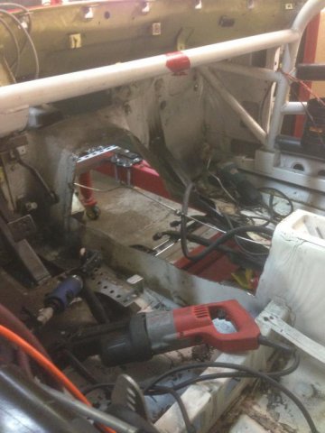

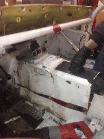

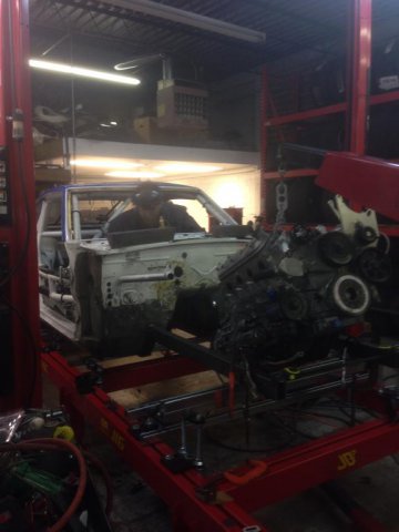

cobramatt Posted February 6, 2014 Author Share Posted February 6, 2014 (edited) Mocking up engine and tranny today. T56 was to big for the tunnel so we made room by just cutting it out on top and will fab a new one. Measurements look good for cross member and motor mounts. Having to play with the passenger side mounting points due to the fact I now have a new starter location. It is no longer internal. I can tell that the passenger side header is going to have to be custom or magic, due to no room and clearance issues, the fuel pump, starter, lower frame rail and motor mount are ALL thats in the way........other than that it fits perfect. I have decided based on our last wind tunnel test a few weeks ago, of two of our Corvette Race cars that widening the front end will be counter productive due to drag. Widening the footprint is a must for handling and we are widening the stance front and rear by 4 inches. We are lengthening the wheelbase by 2 inches as well. Our new length of wheelbase is 94 inches compared to a stock of 90.7. Our wind-tunnel testing showed that a widened front nose and fenders lost 9.8MPH at 150MPH due to the added drag trying to punch a hole through the air. We then found that a nose fascia that was stock but the flares were extended over the widened wheel base lost virtually no speed and created very little drag. Thus I will be adding to the width of the flares over the tires, which also lets me add a touch of strength and rigidity. The plan on widening the g nose and hood are now unnecessary. I also am very happy to report that our side skirts were hugely successful and created almost no drag and increased downforce considerably. I have known this on my Datsun due to actual road course testing at high speed but never had seen the wind tunnel reports. The feedback from my Butt matched the wind tunnel reports exactly..... I am sure you understand but please dont ask for any of the actual numbers from the wind tunnel. Also something very exciting is that the engine is 100% behind the front wheel hub center and by definition that makes this a mid engine car. More to come........... Edited February 6, 2014 by cobramatt Quote Link to comment Share on other sites More sharing options...

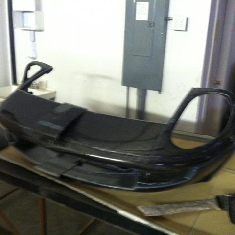

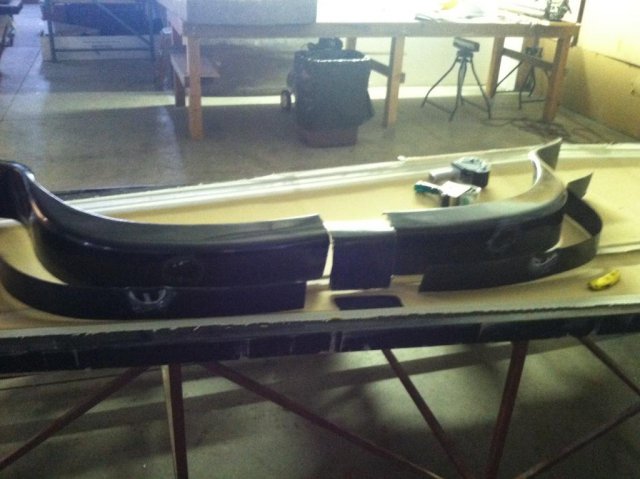

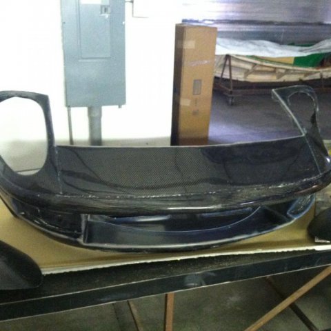

cobramatt Posted February 7, 2014 Author Share Posted February 7, 2014 New Carbon Fiber parts fresh out of the molds. New G nose and new upper and lower air damn. Hood is next. Our Lead Engineer, Will Stukus. Responsible for most of the geometry on the front clip. He's contemplating............I think. Quote Link to comment Share on other sites More sharing options...
