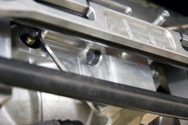

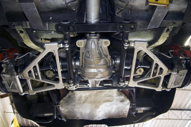

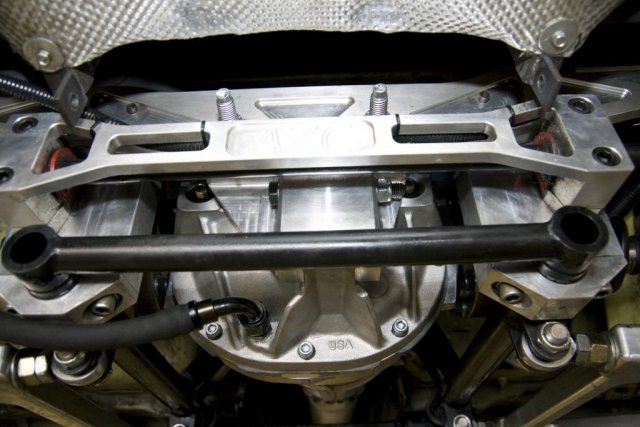

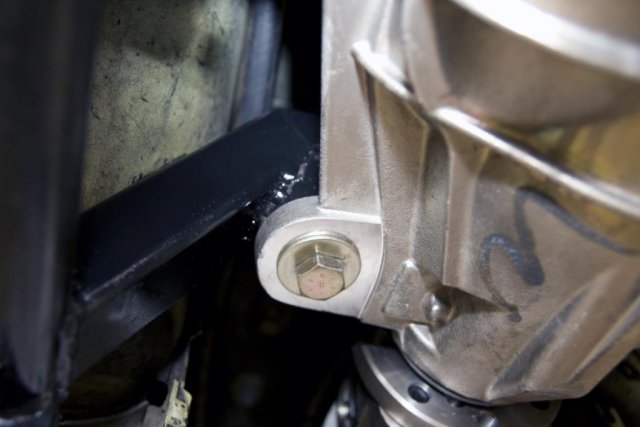

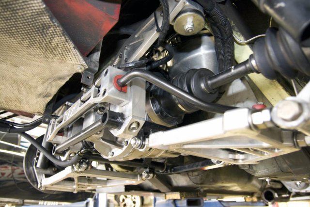

All new Ford Motorsports Racing 8.8 aluminum independent rear end (the one that they just decided to stop making), new 3/55 gears, all new mounting brackets and structure, one off fabricated billet mounting bracket, custom one off I guess you would call them stub axel extensions, re splined axels, new cv and boots, drive shaft didn't need any work (its good to save a few pennies), and to add I have an all new AP Racing big brake kit installed on all four corners. The same set up that I run on my WC Corvette. Now, I only have to buy one type of rotor and the same pads (CarboTech XP20's) for both cars. Its funny that my old front rotors and calipers (Willwood) look like the rears in the new kit. I've got twice the pad on the rotor now. I decided against any ABS as I've never had it anyway.
I hope everyone likes the new set up. I have NASA races all weekend at Road Atlanta and Friday is our test and tune. I hope the dyno frees up tomorrow so I can just put the car on it and run up and down through the gears and let it put some slower miles on the diff then let it cool, drain it and then some more. That way Friday I can be a little more aggressive in testing. I'll also need to bed the brakes and fiddle with the bias.
Going flat out is a lot about trusting your equipment. It will hopefully give me a sense of confidence in the new rear end as I think we really hit this one out of the park and given the car a real dependable and solid diff and the brakes on four corners can only pay dividends with practice and patience finding a little time in the deeper brake zone.
If anyone is interested in buying my old willwood brake kit or my old Q45 Pumpkin with Carbonetic diff (the ring and pinion is what kept failing me) I think with a new set of R&P gears and you aren't flogging it like I was I think you would have a nice set up. Anyone interested give me a call or PM and make me an offer.

MIke,
I'm really looking forward to the coaching. I want to absorb as much of your course knowledge as I can and really appreciate your taking the time to help me. What do you think of the pictures of the new 8.8 rear end? I think it's a work of art and not to my surprise it puts the power down better than before. The difference has also changed the setup in that I had to trim the car out due to high speed understeer. It just seems that now that the rear is hooking up better than before and  the overall aero was effected as well. I tried to dial in some more front mechanical grip but with the clutch master cylinder going out on my second lap of Friday testing I got no seat time and just has to wing it for the race. We won over my teammate by .4 seconds. It was a very hard fought battle where once again the faster car did not prevail. Good traffic management and spotting helped keep them in check, and a little (legal) blocking.

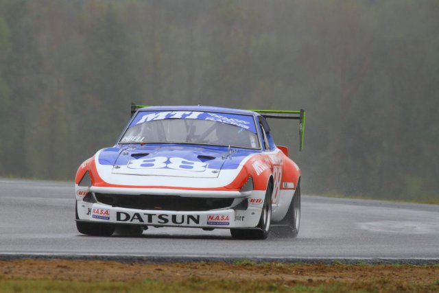

A few pictures from this past weekend at VIR with Mike Kelly and the MTI Racing team.
Matt, the head on picture above is a prime example where when the car rolls a large portion comes from the inside jacking up.  I'm not sure if you have seen any of the threads on droop limiting but this is what is addresses.  Maybe something to think about.
Cary
Thank you Cary. I needed the car to be as soft or loose as possible due to the wet conditions. I agree with you and in dry conditions we stiffen the car up considerably. Good eye.....
looking at the same picture, you need to fix the widow sticker or slow down.  the force of the air is taking it off.
he he
jimbo
JImbo,
I said to my vinyl guy as soon as I saw the picture that I want to have that fixed. It is not noticeable when the car is sitting still and obviously I don't get to see the car in motion from behind the wheel.
I'm on it.
