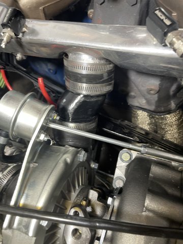

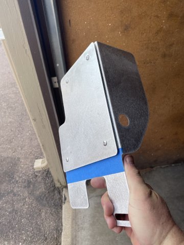

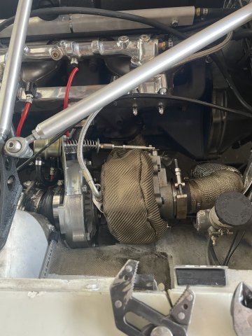

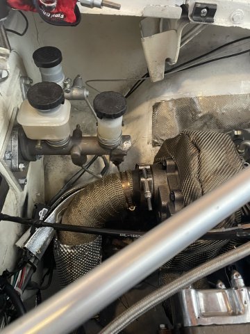

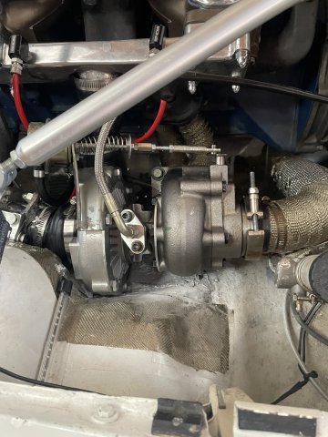

  3. 06-28-2025. Putting the new turbo on. With the new turbo to manifold piece, I had to actually remove the intake manifold, put it all together, and then slide the manifold back on. It WORKED! Look at those HUGE ports! I haven't seen them in awhile! That's my Russ Racing prepped and shaved E31 head! I have it almost all assembled, I had to "slip" the top hose clamp up a bit to get a really good seal clamped down. Looks "different" but it is SNUG. I vacuum tested the new wastegate actuator......WAY too high (boost crack at 15 psi !!!) , so I put the older one on, and it boost cracks at only 2.5 psi.,....but I didn't port the turbine housing this time, so keeping that in mind, I think very little boost will be bleed off....enough to protect the engine, but it's going to pump quite a bit of air and fuel! (boost creep expected). The Skillard brake master cylinder heat shield I ordered came in, and is waiting me to custom mod as needed and install. Also went ahead and started clamping down the vacuum hoses to avoid any more hoses blowing off under boost. I have also added on a few pics of my intake ports if interested. Almost done! It is now HOT, have to keep stopping and wiping my face off. I think it was over 86! cheers! pics attached.
