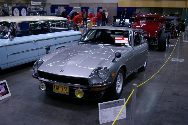

Good to see someone else restoring/refreshing/rebuilding another FairladyZ!
To inspire you, here's how mine ended up.
1971 FairladyZ-L
