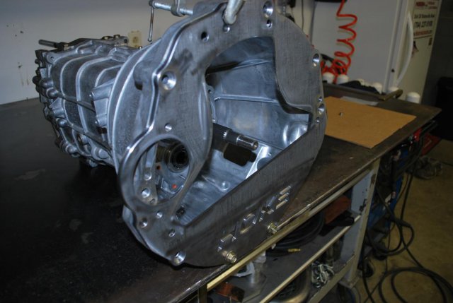

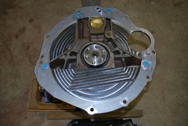

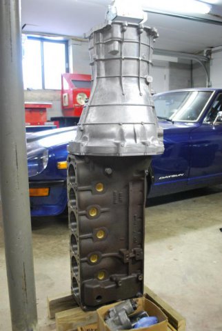

More progress on the adapter plate this past week,  I recieved the first prototype plate.  So far it is looking very promising,  everything bolted up nice.  I am waiting on a few more parts to get in before I can finalize measurements for the flywheel spacer and starter adapter.  With any luck I may have a protype kit ready to test in a month or so!
I also had a L28et car in my garage this past week and got a chance to take some measurements for the shifter location.  It looks like the shifter relocater which I already make for VQ swaps will place the shifter in the stock location!  I was more worried about it before because I have my VQ back against the firewall which is a couple inches further rewards then it will sit mated to the L28.
Attached File  DSC_0493.JPG   90.42KB   2 downloads
Attached File  DSC_0496.JPG   99.01KB   1 downloads
Attached File  DSC_0502.JPG   50.57KB   2 downloads
Will post more updates as I go.
