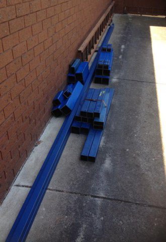

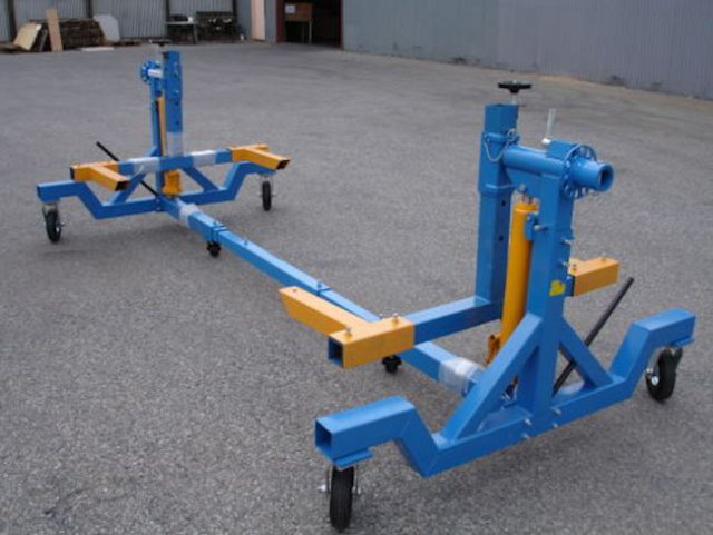

The following is a series of pics starting with fabricating a rotiserie from the plan and pre cut pieces I ordered a month ago.
In order to get this chassis even half way set up correctly with the limited tools and technology we had on hand, this had to be done.
Afterwards you will see the genesis of the chassis as it developed, a friend of mine and fellow clubman Z owner and I finished the entire mock up squared and true on the car up to the rear section where it dives upward back to the rear hatch floor pan, that will have to wait for another Saturday as there are fair few redundent mounts etc plus a sectionisation required in two sections to accomodate the set up.
All in all, even though Lochlan was pretty reserved when we first started the new chassis, I think even he saw the versatility it will deliver..............I hope anyhow.

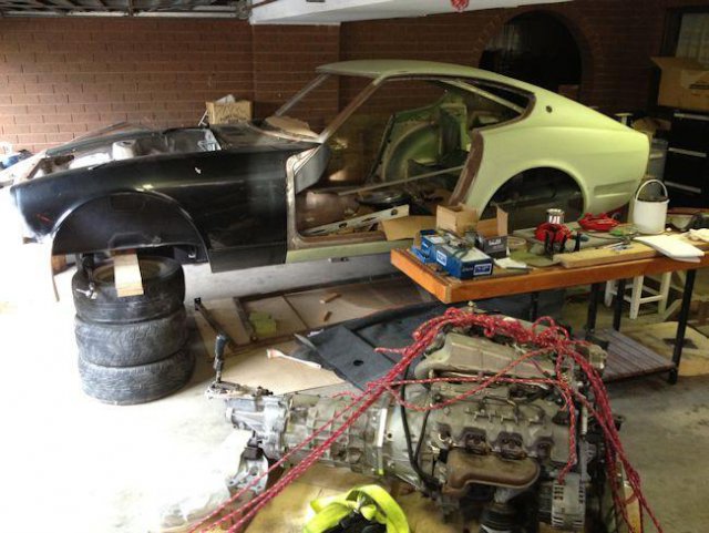

Some progress today on the chassis build.
Having had all the time in the world since Lurch and I made a start on the chassis over a year ago, and with the completion of the new cross member, I decided that some major redesign needed to be undertaken due to the impediment of the front tension bar mounts which we initially built around and meant that the chassis couldn't be dropped out of the body.
So unfortunately they came out today and I started to fabricate new sections.
With the new cross member assy now bolted to the car rail mount points, I was able to fabricate the new chassis rails which sit on larger mount plates on the cross member. These new chassis rails will eventually be welded to these plates permanently therefore forming part of the new chassis.
The tension bar mounts will now be fabricated and mounted to the new chassis rails therefore removing additional stress on the original rails and skirts.
Forward of the new cross member, I will be adding mount plates in each corner where they meet the front radiator support and using the tow hook mount points on the bottom of the radiator support panel so as to further anchor the body to the new chassis.
Working back from the front cross member, I will be fabricating mounting plates on each new chassis rail which I intend securing to the originaltransmission mounts on the "Z".
Stay tuned.............
