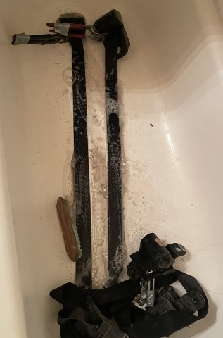

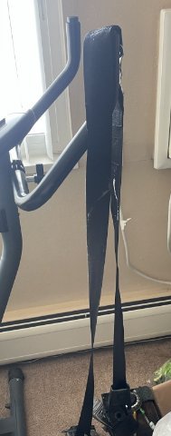

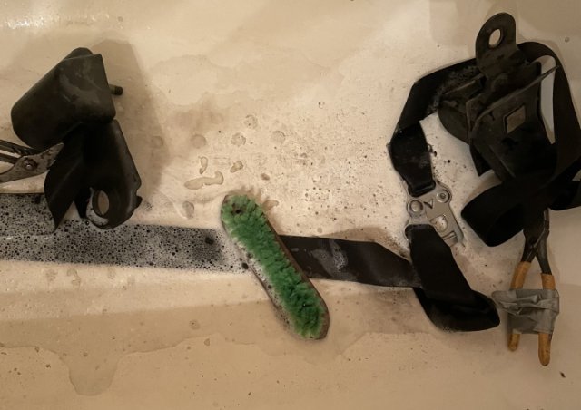

03-06-2026 ATLAZ Z UPDATE. Well, today was Seat Belt Day! When the tub and walls need a cleaning, you go ahead and grab your 52 year old belts, some pliers and duct tape to hold them extended and grab a heavy duty brush, some dish washing detergent and get to it! The water going down the drain was a dark brown soup. Dirt, dust, skin, body oils, everything. You know they never get cleaned. Once dry I will have to paint the housing with the SEM Interior paint, but they will be nice. Oh and the tub is all clean and disinfected with Pine Sol! PICS:
