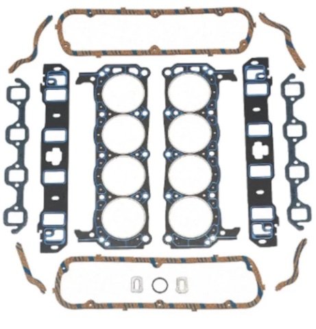

No, they look really good, have a little metal in it, and have some rtv type material around all jets, not paper. - Today
If they have the standard paper intake gaskets, throw them on the garbage and get the FelPro S3 gaskets. -
Good tip. I’ve got trickflow heads, so I got their gasket kit. -
What intake gaskets do you intend to use? I like the FelPro 1262S3 or 1250S3 depending on the intake part size. The S3 version of the gaskets are much more durable than the standard Felpro gaskets. I also apply a really thin smear of Right Stuff RTV around the water jackets when I install the gaskets and lower intake. - Yesterday
