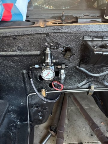

Thanks guys. I got the timing cover and water pump on, ordered a windage tray then I can get the oil pan on and start working on the top. Mounted the fuel regulator started making some fuel lines. Need to figure out filter placement then I can cut and finish the rest of the lines. I’m using black for fuel, red for return and blue for vent. -

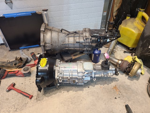

Nice, you’ll be good. Yep, I went with same gearing, but I got a 3.3 in the rear. -

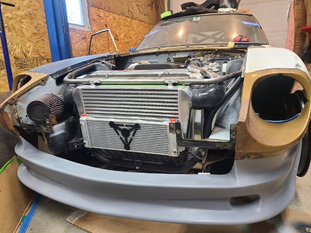

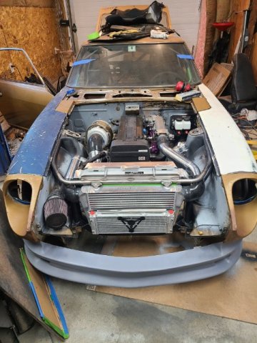

I plan on boxing it all to the grill opening as well as venting the hood just behind the radiator. direct air in and give it a place to go. I have 2.87 first and .81 5th. I have this gearing in a 2jz 240sx with a 3.73 rear and pretty happy with the ratios. so i'll see how 4.08 rear gear works with it on the local tracks. -

Looks good, what gearing did you go with the on the TKX, I got same bell housing too. I would definitely do some ducting to help get all the air you can through all of that. I have a TT 370Z I track occasionally, oil cooler/intercooler/radiator all stacked similar to you, after about 5 laps or so I need to do a cool down lap to get temps back in range. Adding some ducting is on my to do list on that car. -

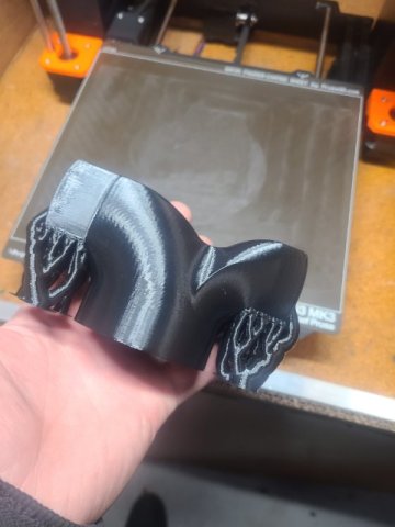

Interesting! I have never heard of keeping it all together like that, you'll have to update as time goes with how it holds up! I'm sure with the outer layer being glassed it will be fine though -

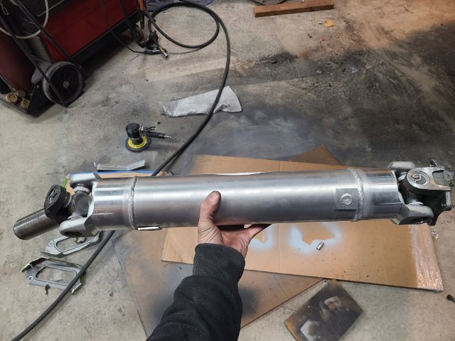

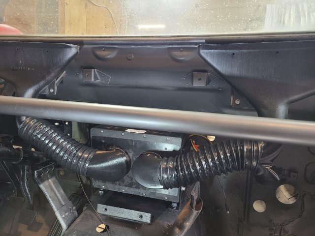

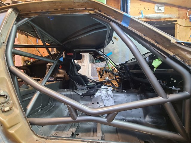

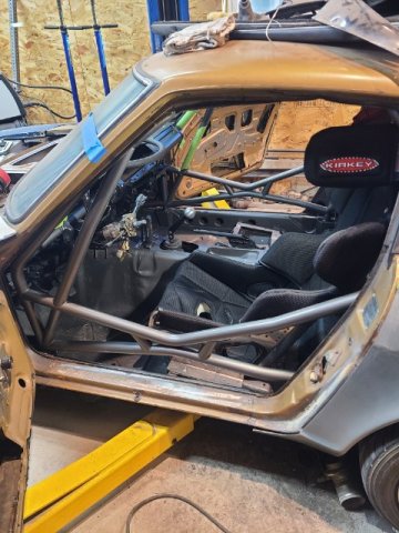

Cage is done. Driveshaft arrived. its comically short. i dont know if i even mentioned it in this thread. I bought the engine with a 350z six speed and tried to fit it and didn't like it so i switched to a tremec TKX 5 speed with a scatter shield. lighter, smaller, better gearing, serviceable. shifter position is great, and not 20+ years old. Mounted a 240z ebrake handle in place to help connect to the 300zx rear cables. Started getting the dash sorted. FIA bars are certainly making it extra challenging to do a clean install. Pedal box is in and throttle pedal is fitted. I don't know what the pedal is even out of but it was sitting in a box that came with the car so I made it work. feels good on the foot. Mounted the heater box to the tunnel. designed and 3d printed some ducts that go to the factory defrost ducts. i also added a small foot diverter for the wifes feet as shes always cold. Mounted the oil cooler. went thru a few ideas between laying it flat and ducting it, stacking it. putting one in the wheel well. etc. Although a 3 stack is not ideal i decided to try it. Can always move it around if its impeding flow to the coolers behind it to much. probably do some sort of screen infront of everything when its on track to keep debris from damaging it. Got my front valance quickly mocked up. I forgot the headlight buckets were a bit beat up so added that to the list of things to fix. drivetrain is basically all set so I am pretty close to pulling everything out and starting bodywork. -

Not a mold. I just left the original 3D part sandwiched between the outer layer of fiberglass, bondo, and paint used for fit-and-finish, and the inner layer of carbon fiber used to ensure the whole part is stiff enough to last. -

bummer about the bolt. pretty common SBF flaw. Engine looks good. TKX will be great addition. They fit the tunnel pretty well. I have one behind my 1jz -

Part 8-The Roll Cage is now installed so the Roof Area is being prepared for the Gull Wing Door Build. A Major Obstacle that I foresee the Transmission Tunnel and Firewall may have to cut open because of the Huge Mercedes Motor and Transmission. But if they are willing to Eliminating the Tunnel and Widening the Firewall Opening, they should not be a Big Problem. -

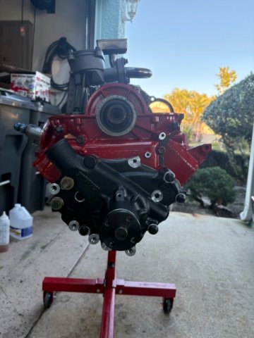

Got timing cover painted. Spent almost half the day dealing with a bolt on the timing cover/water pump that had broken off in the block. Tried all types of extractors, ended up having to drill it out and re-tap it a size bigger. Got the oil pan off and installed new pump and pick up for the new baffled oil pan. Got the main seal on, set the timing cover on and called it a day. -

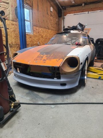

That has got to be the best balance of Form and Function of a Datsun that i have EVER Seen!! Absolutely amazing!! -

Dang, that looks so tight, turned out amazing! So they printed the part but then used that to make a mold I'm guessing? That's not the actual 3D printed part? -

if anyone's still tracking this build I have what might be a last update since the car is mostly done (lol is it ever done?). I finally cad-designed the front fenders and then had a local shop 3D print the parts, then took that to a bodyshop to integrate into the existing fender part and paint it. After that I overlayed the inside walls of it with carbon fiber for added stiffness and protection. I also cut the lower part of the rear fenders and put in a horizontal cf winglet to better extract air. Overall I think it looks great and the resulting new parts helps downforce a ton by extracting air from the wheel wells. -
