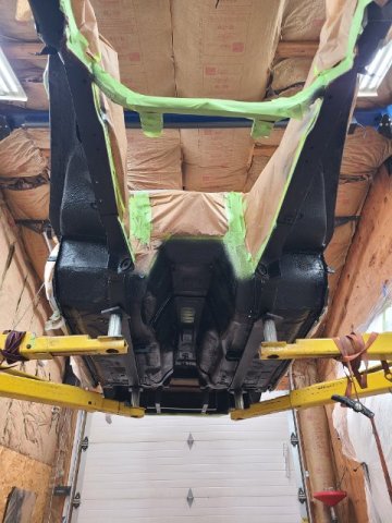

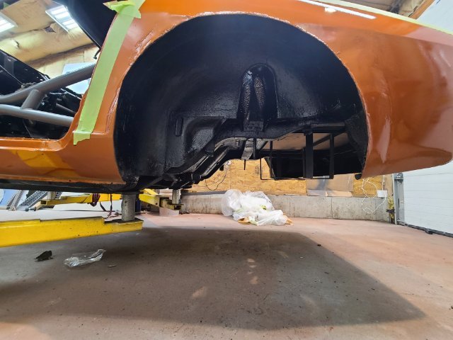

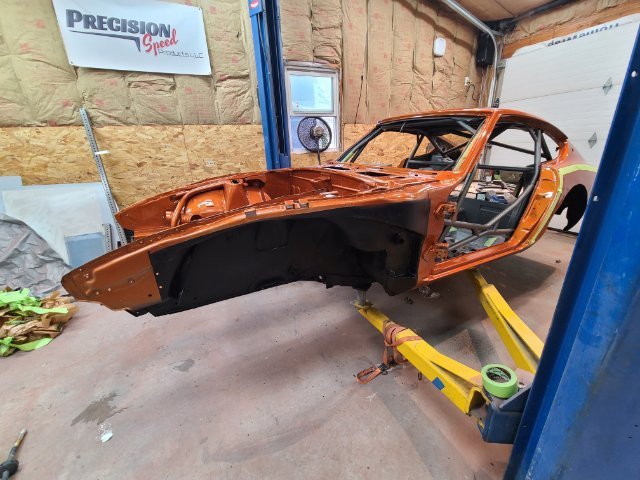

finished stripping and cleaning the underside and inner wheel wells and sprayed with some raptor liner. The raptor liner is popular around the youtube builds and I can see why. sprayed nice, covered nice, cured up nice and looks great. Taping up the fresh paint was a pain but came out great. - Today
Thanks. Interior is gonna be, black carpet in the front half. (unsure on door panels based off what will fit) Rear half will be a combination of the semi gloss charcoal grey that the cage is and some black with the raw aluminum bead rolled panels around the cell. May carpet the wheel tubs for a more "finished" look. The color goes real well with gray/black. -
FastFloridian replied to flatout's topic in S30 Series - 240z, 260z, 280z
Came out great, love the color. Whats the interior color or colors going to be? -
Long week number like 200 but happy with the my progress. Made a tweak to a color based off a cadillac cts5 v blackwing. Its a bit more "copper" tone of orange than I was picturing with the modifications but I am very happy with it. As soon as I started pulling the masked off areas and was seeing the contrast with the grey I loved it. Did get some fisheye on one door so I'll have to fix and respray that at some point and a couple sags/runs in the clear to sand out, but I can make some serious progress on the build now. did get the engine stripped down as well. Bearings, rings, valve springs and a gasket kit have been ordered to freshen it up. but otherwise everything measured out good and seems like a good starting point. - Yesterday
