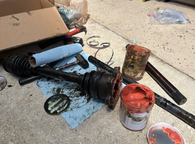

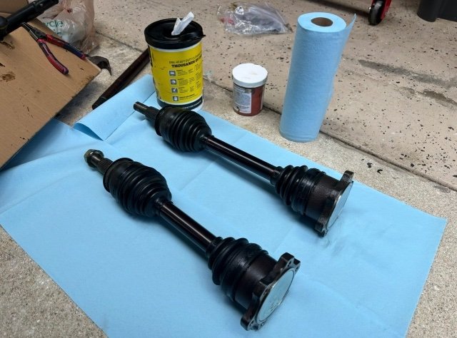

It was messy, but axles are put back together. Overall pretty easy with the correct parts, probably spent more time cleaning up all the grease 😂. - Today

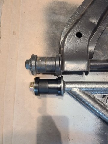

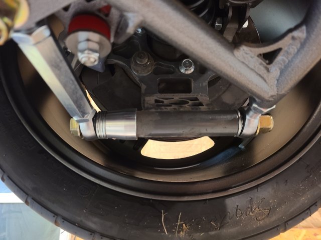

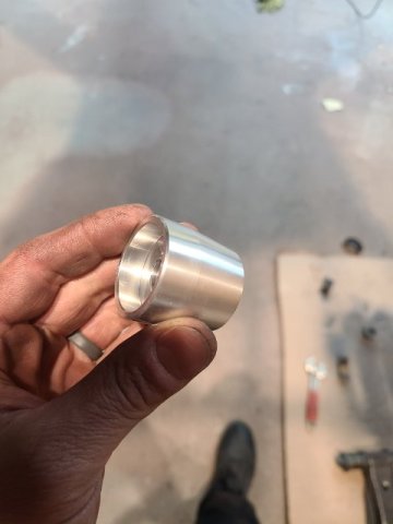

They did send me another set of control arms which was nice of them but they are also a bit short. I did make some modifications to make them work. the kit is supposed to use 8 washers per side but i needed more to align the toe adjuster up, I do have T3 spindles so that may be part of the variation I was seeing. So I machined some spacers because stacking 15 washers was not my favorite design. The spacers tightly fits over the spindle and then takes up about an inch of space and allows 5 washers for "adjustment" The guy from apex did called me and we chatted for a bit about some other design concerns I have. Which was great and he took it well. Apparently they just aren't good at measuring things. They said they are going to try and make me a shorter set of front control arms aswell because the front setup at its absolute max shortest setting is still .375" wider than the stock assembly which doesn't allow me to use any of the roll center or control arm adjustments with my wheel and tire combo. I was hoping to correct geometry with everything being adjustable but that's not the case since the crossmember mounting points are wider than the factory one so I had to max everything out to its shortest point to even fit. With that said I have been plugging away at stuff, brake lines are ran, rear suspension is in, engine is assembled. adapter kit for the trans is machined, body panels are getting put on. started on the interior, everything takes so long. painting brackets and hardware and aligning everything but i am very happy with how its coming out. I was told the car came with a 240sx diff, its actually a j30 diff so it has a 3.91 gear ratio. That may be a slight advantage so not to mad. Anyway, after all this reading. enjoy some photos. -

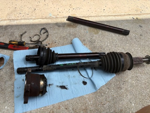

Might be a month or so before I get to it, but I’ll post updates. Figured I’m moving all the guts to the carbon fiber doors, why not see if the auto stuff will work. Played with one of the axles last night, fitment seemed good and went together really quick when they are manufactured correctly 😅. -

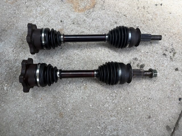

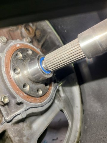

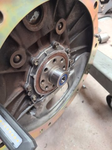

New axle shafts came in today, woohoo. Now that’s how the snap ring is supposed to sit. Hopefully I can put them together this weekend. Also got some other goodies, push to start electronic locks and window kit. -

Flatout got a set of control arms that were made too narrow and don't fit. Apex seems to have been sending things very slowly lately and then having a low rate of good parts when they do send them. -

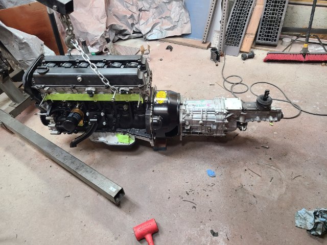

Apex said that batch with the new vendor had the groove to short, they are sending some new ones. Glad it wasn’t me, was racking my brain trying to figure out what I was doing wrong. Go the rockers and intake on today, engine is getting close to done. -
