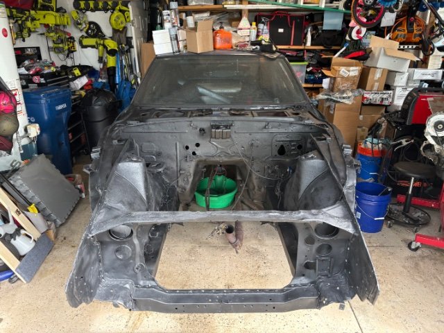

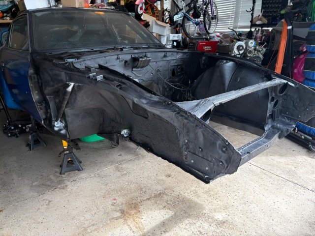

All painted. Going to do another coat of semigloss for the engine bay, but frame/fenders are ready for suspension 😁 I’m hoping to start next weekend - Today

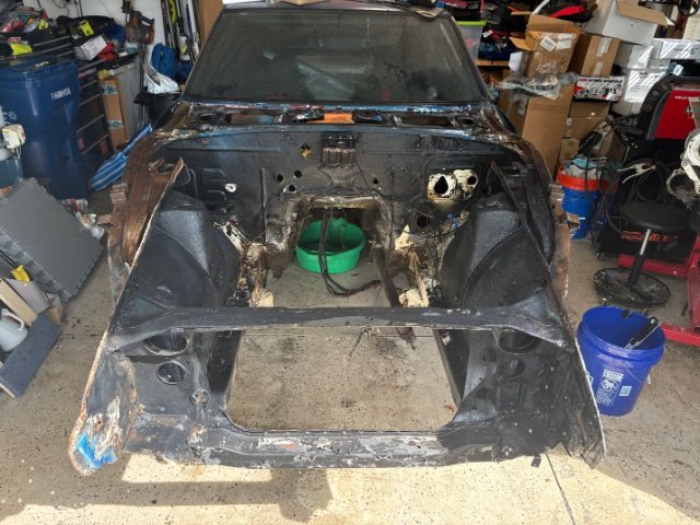

Did final scrapping and cleaning of engine bar and fender area. Dried and going to get first coat of paint on today or tomorrow. -
