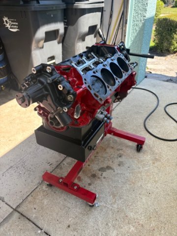

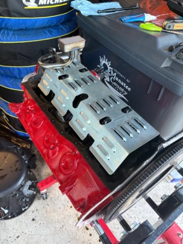

Thanks guys. I got the timing cover and water pump on, ordered a windage tray then I can get the oil pan on and start working on the top. Mounted the fuel regulator started making some fuel lines. Need to figure out filter placement then I can cut and finish the rest of the lines. I’m using black for fuel, red for return and blue for vent. -

Nice, you’ll be good. Yep, I went with same gearing, but I got a 3.3 in the rear. -

bummer about the bolt. pretty common SBF flaw. Engine looks good. TKX will be great addition. They fit the tunnel pretty well. I have one behind my 1jz -

jhm replied to FastFloridian's topic in S30 Series - 240z, 260z, 280z
Ugh...broken bolts in the block. What a pain. At least the motor was already out of the car! 👍 Making great progress -- keep the updates coming!! -

Got timing cover painted. Spent almost half the day dealing with a bolt on the timing cover/water pump that had broken off in the block. Tried all types of extractors, ended up having to drill it out and re-tap it a size bigger. Got the oil pan off and installed new pump and pick up for the new baffled oil pan. Got the main seal on, set the timing cover on and called it a day. -
