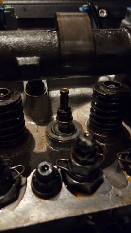

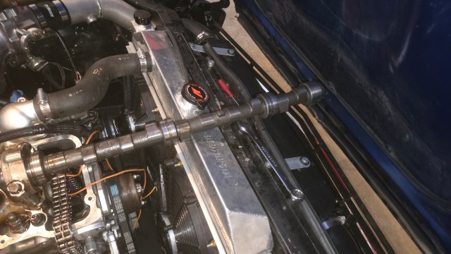

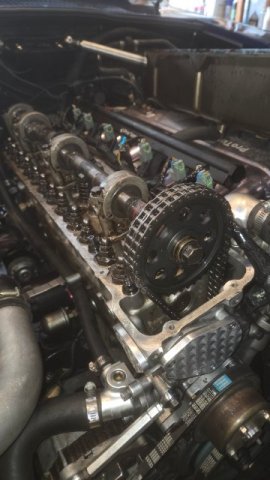

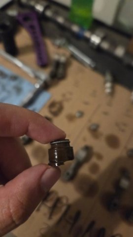

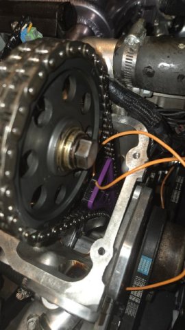

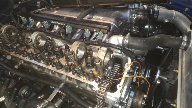

New parts arrived. Valve stem seals replaced. Several weren't even fully seated anymore and one was torn! Glad I suspected them for the oil burning when I realized just how much oil I was going through but the compression tested good. Aside from replacing the rear main seal, I think this is officially the most involved work I've done on an engine. Got the old cam out this morning and new cam in. Managed to get it out without removing the hood fortunately. Tested wipe pattern on the first two valves. Will try swapping the lash pads to see if it's better or worse. But if it's about the same I'm gonna just send it. - Yesterday

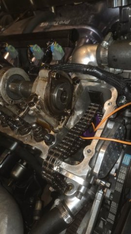

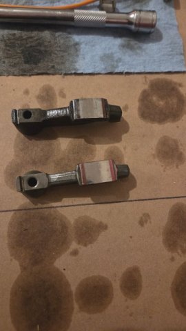

New turbo cam from Steve Bonk arrived this weekend! Excited to see how it changes the responsiveness on the turbo and hopefully I'll get much earlier spool and more pleasant street driving. I've started disassembling for the installation and checked everything. It looks like previous builder used different lash pad sizes for intake and exhaust, which wouldn't seem that odd on a "proprietary" grind, except every one of the shorter pad sizes had the wipe pattern pretty far to the pivot side of the rocker arms and the taller ones were nearly perfectly centered. I know the one time I did a valve adjustment a while back wasn't perfect with my limited experience, but I find it hard to believe I'd be that far off with how paranoid I was about using the right feeler gauge for intake and exhaust. One of the intake rockers and the lobe it was on were fairly damaged but everything else looks good. Got some advice from Steve on the lash pad sizing based on my current specs. I'll be ordering new pads tomorrow and hopefully two new rockers to replaced the damaged ones I found. Also ordered some new valve stem seals. Figured now was the best time. -
