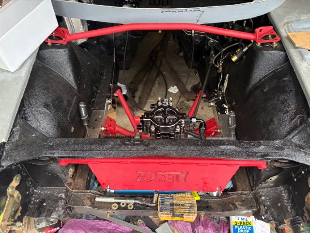

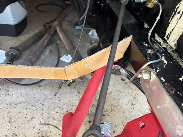

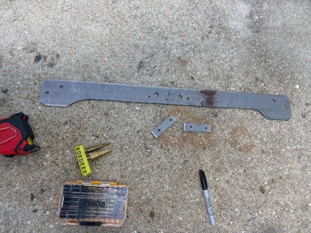

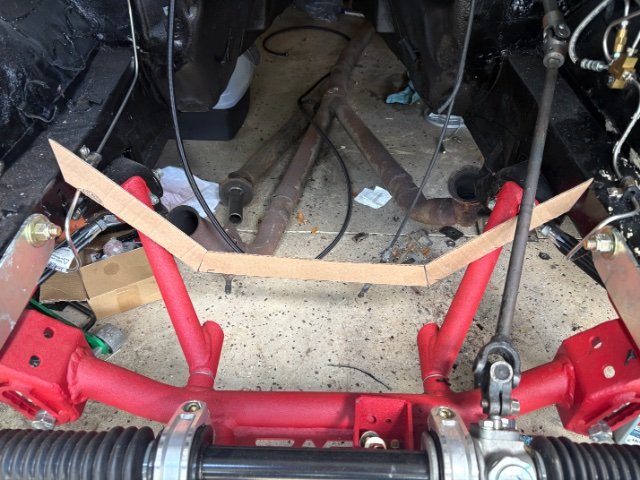

Well bit of a bummer this weekend, I made a mock up of the engine cradle out of cardboard and it doesn’t fit, the extra bracing on the Apex track attack kit interferes. I made a mock up using 1-1/2” instead of 2” and it might work, still a little tight. I’m going to try and make it with the 1-1/2” and change the geometry a little, hopefully it’ll work. Since no fab/metal shops were open over the weekend to get the 1-1/2” tubing I decided to make a bracket to mount my clearview remote filter. I’ll get it painted and re-mount it. Not sure this will be its final location, but I’m happy the way it came out. -

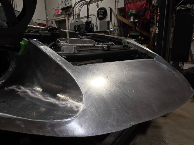

work has been to busy, small update. Headlight bucket has been welded in and planished. Everything is starting to look alot better and starting to feel like an actual car again, not just pieces.

Someone mentioned steering shaft clearance? I can't see how....tiny engine in a big bay.......

Painted the bracket and snugged it up, happy with the way it fits. I’ll add a few more bolts but waiting to incorporate the bolts into a bracket I’ll make for the oil cooler when it comes in. I really need to get this engine back in, so I picked up some steel today, going to try and fab an engine cradle following the specs Brian Laine has posted online. Hopefully I’ll get some time this weekend to start on it. -

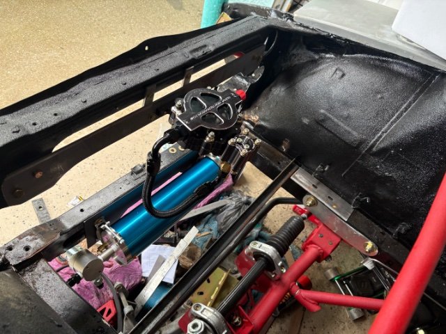

Got an Accusump for the Z, and made a mounting bracket for it. I’m going to have another plate on the front side to weld on some angle iron for the oil cooler to mount on. Added a pressure sensor so I can read the Accusump oil pressure with the engine oil pressure so I can see when it’s charging and discharging. the bottom bolts are just to hold the clamps and it’ll sit up slightly higher when it’s tightened up.
